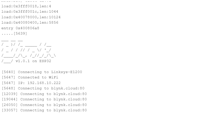

Unable to connect my ESP32 with static IP on my network with Blynk, please help me!
I have to connect an ESP32 on a network with a static local IP address, I mean without using DHCP.
If I try the following sketch I get in return (with the serial debug).
but i can’t log in?
mode:DIO, clock div:1
load:0x3fff0018,len:4
load:0x3fff001c,len:1044
load:0x40078000,len:10124
load:0x40080400,len:5856
entry 0x400806a8
…[5676]
/ _ )/ /_ _____ / /__
/ _ / / // / _ / '/
//_, /////_
__/ v1.0.1 on ESP32
[5677] Connecting to blynk.cloud:80
[10678] Connecting to blynk.cloud:80
[15679] Connecting to blynk.cloud:80
Whereas if I use the second sketch it works, but Blynk.begin() does not allow me to connect my ESP32 with a fixed address on my network, how to solve this problem??

I get the following result:
[14134] Connected to WiFi
[14134] IP: 192.168.10.174
[14134]
/ _ / / // / _ / '/
//_, /////_
__/ v1.0.1 on ESP32
[14140] Connecting to blynk.cloud:80
[14823] Ready (ping: 204ms).
Blynk connected Succesfully
First thing you’ll have to do is removing the delay in your loop void…
I’d remove that, and replace it with Blynk.connect(); as well as removing the delay() from your void loop.
Also, your WiFi.config is missing the dns_ip
It should be:
WiFi.config(device_ip, dns_ip, gateway_ip, subnet_mask);

Thanks Pete for your answer, I tried with the changes you advised me, but it doesn’t work either, so I tried with those changes there but it doesn’t work either. as soon as you want to work in fixed IP it’s a hassle.
  delay(3000);
  WiFi.begin(ssid,pass);
  while (WiFi.status() != WL_CONNECTED)
      delay(500);
      Serial.print(".");
  Blynk.config(auth);
  Blynk.connectWiFi(ssid, pass);
  //delay(2000);
Result

It should be quite easy to get it working. The problem is that instead of staying on one logical path, you are jumping around all over the place and using commands that are nor relevant to the task that you are trying to achieve.
EDIT
@plaurenc I owe you an apology - In my earlier post I gave you the wrong syntax for including the DNS within your `WiFi.config) command. It should have been:
WiFi.config(device_ip, gateway_ip, subnet_mask, dns_ip);
I suspect that this may have sent you down a couple of rabbit holes in your testing.
I tested your code with my suggested changes and obtained the same results as you, but when I replaced your WiFi connection code with my standard code it worked
This code works (but you’ll need to add your own credentials and change the IP settings)…

This is the serial output…
ets Jun  8 2016 00:22:57
rst:0x1 (POWERON_RESET),boot:0x13 (SPI_FAST_FLASH_BOOT)
configsip: 0, SPIWP:0xee
clk_drv:0x00,q_drv:0x00,d_drv:0x00,cs0_drv:0x00,hd_drv:0x00,wp_drv:0x00
load:0x3fff001c,len:1216
ho 0 tail 12 room 4
load:0x40078000,len:10944
load:0x40080400,len:6388
entry 0x400806b4
Connecting to Wi-Fi...
Wi-Fi connection - attempt # 1 of 30
Wi-Fi connection - attempt # 2 of 30
Wi-Fi connection - attempt # 3 of 30
Wi-Fi CONNECTED
IP Address = 192.168.1.123
[3149]
    ___  __          __
  / _  / / // / _ \/  '_/
 /____/_/\_, /_//_/_/\_\
        /___/ v1.0.1 on ESP32
[3158] Connecting to blynk.cloud:80
[3201] Ready (ping: 9ms).
Blynk connected Successfully
Ok Pete, I will try this ASAP get you informed
YESSS !!! It’s working
In first I tried your sketch by modifying the identifiers only and I still had the same problem, so I upgraded ESP32 core I was in version 1.0.6 I am now in 2.0.2 and everything works perfectly. Thanks Pete for your lights
