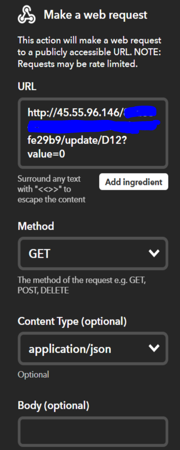

Well, If I don’t specify the port 8080 on the PUT request then it doesn’t work.But I am so confused now, I just got some examples from the forums and made it work with the IP, PUT and the port 8080… Do you know how this really works? or perhaps some resources that I can read to really understand it? (I am pretty OCD and like to understand what I’m doing)
So, anyways, I tested with the GET method and worked like a charm… Also gave it a try with blynk-cloud.com (instead of the IP) and worked as well… For those in doubt of how to configure it in IFTTT, here is the screenshot:

  • There is a Blynk API documentation site where you can actually test the different methods (PUT, GET, POST, etc) and see the request sent to the Blynk server and the response received - Here it is: Blynk HTTP RESTful API. The requests can be sent either through apiary or through your local browser installing an extension. - I did different tests to set the PIN to what I wanted and they all worked flawlessly.
  • The server IP is no longer required and the blynk-cloud.com server can be used directly on the request. Please see this post for more information. - I also tested this several times (IP and DNS name).
  • The network port is also not required (at least for cloud servers) - I did my test with and without port and both worked (tested from IFTTT).
In summary, I think I will use GET for my purpose as I think it’s cleaner, but PUT works as well without any issue.
