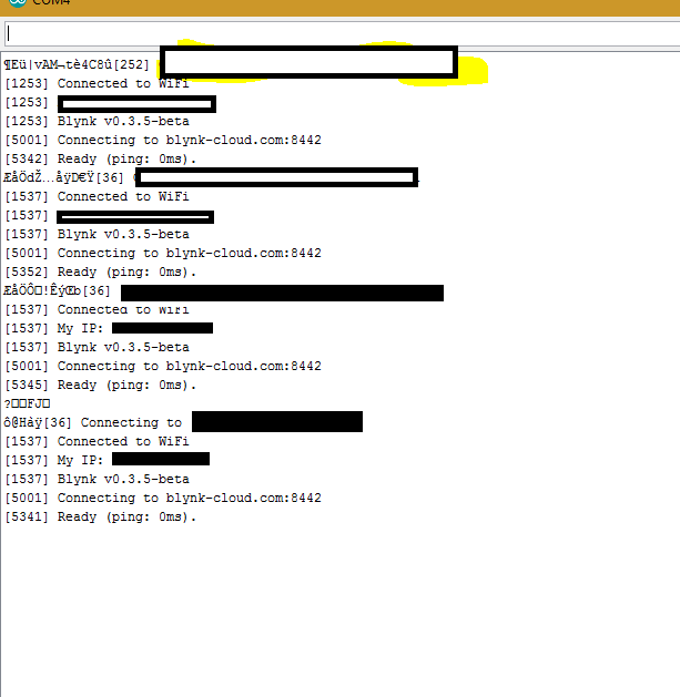

But now the esp reboots to infinity after connecting to the wifi and displays ready in the serial monitor.
Is this a bug in Blynk or with my code? and maybe because I have a rough 3.3v from the power supply.

@claytoncamilleri100 is your system that mission critical to 10 milliseconds?
You wouldn’t normally have the functions with a timer AND in the main loop. Suggest you lose the main loop function calls and increase the 10L to 10000L (10 seconds).
You mean this part? I changed the time to 10 sec but still rebooting
  timer.setInterval(10000L, clockDisplay);
  timer.setInterval(10000L, turnon);
  timer.setInterval(10000L, turnoff);
And loop as:
The clock display which just shows a log entry in Serial Monitor would be ok as you had it (1000L).
Thats odd I commented these lines and it stopped rebooting and started telling me the time.
  //pinMode(red_pin, OUTPUT);
 // pinMode(blue_pin, OUTPUT);
 // pinMode(green_pin, OUTPUT);
