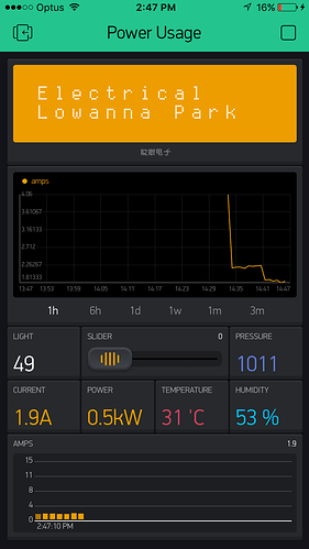

@NickMurray - which enviro. sensors are you using?
Cheap eBay ones. Haha. DHT11 for humidity and temperature. BMP180 also for temperature and pressure and some generic no name LDR for light.
Lol, obviously accuracy is not number 1 priority then? (no offence)
More “just for interests sake”, still nice to have!
I’m running BME280’s and matched set of DHT22’s in my ventilation controller, and even these are a few percent tolerance… But i don’t think spending 25 bucks a sensor is gonna get me a better result than these 5 dollar ones…

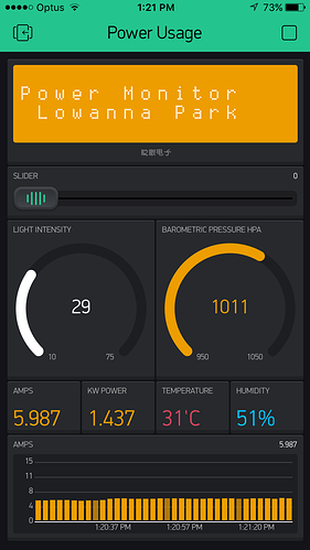

Is your power monitor anything interesting? I’ve got Efergy on our meter box, but wondering if I could hack it’s WiFi signal via esp8266?
Hi Dave,
I would like good accuracy eventually but I guess I’m just in the experimental stage at the moment. I’ll look into the sensors you have suggested.
The power monitor is a bit of a ‘loose’ term for what I have. I just measure the current using a very inexpensive SCT13 split core CT, again from eBay. Use the current value from the sensor, then use a calculation in the Arduino sketch with nominal values of voltage and power factor.
The split core CT just clips onto my mains cable so no messing with the house wiring. It is freakishly accurate when compared to a good quality fluke clamp on amp meter that I have.

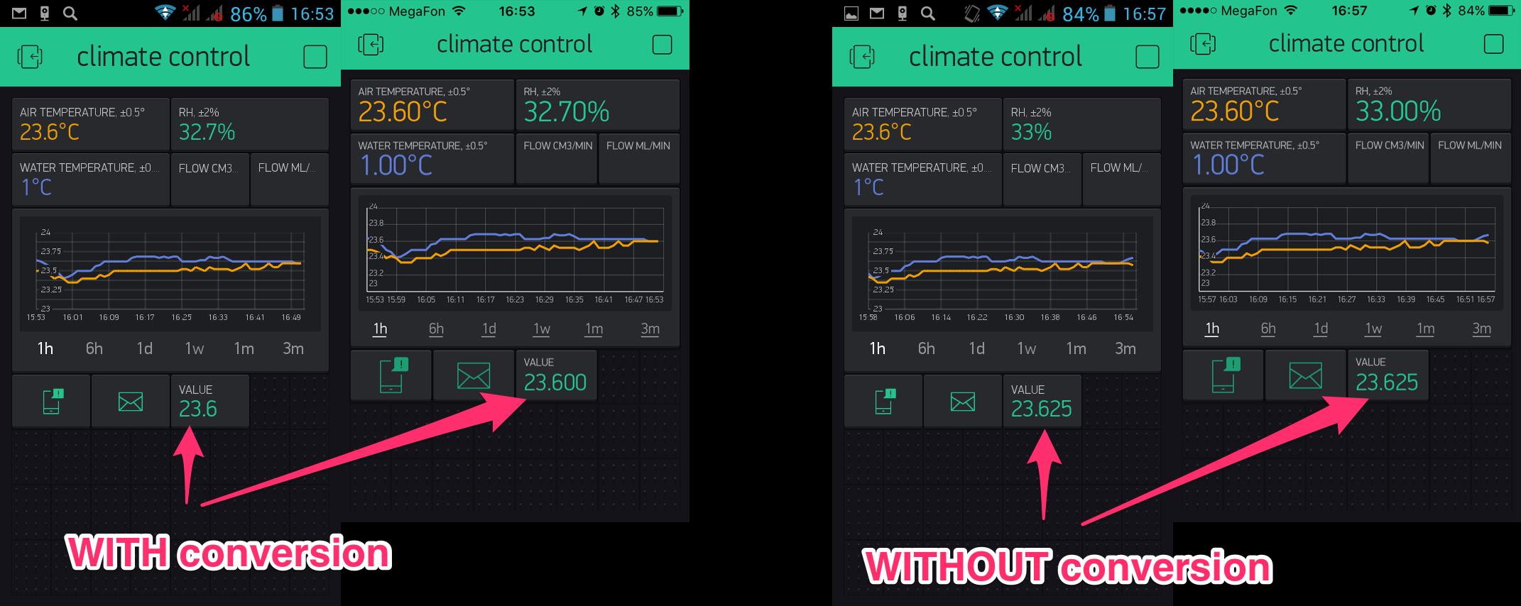

@iGonch I have no idea why iOS does not respond to the float to int rounding and back to float fix.
Are you saying losing the zeros is ok for you in Android or you need to see so many zeros? If so how many zero do you require? It’s probably done by multiplying by 100 / 1000 and adding 50 / 500 for rounding etc.
Thanks, Costas!
Well… IOS insists on 3 decimal points in Value display widgets, regardless of my efforts(
Is there a way to convert this variable to character, then specify its length in code, and then send it to widget?

@iGonch Hi Andrey, does it work for you ?
It HAS to work (for him, and everyone else) as this way the value is send as a formatted string! And the dtostrf is the only function (or am I wrong?) supported on Arduino ide to do it. Unfortunately printf() does not work with floats by default in Arduino IDE. I’m using dtostrf() too, though would prefer printf()
yes! it works perfectly! thanks a lot!
