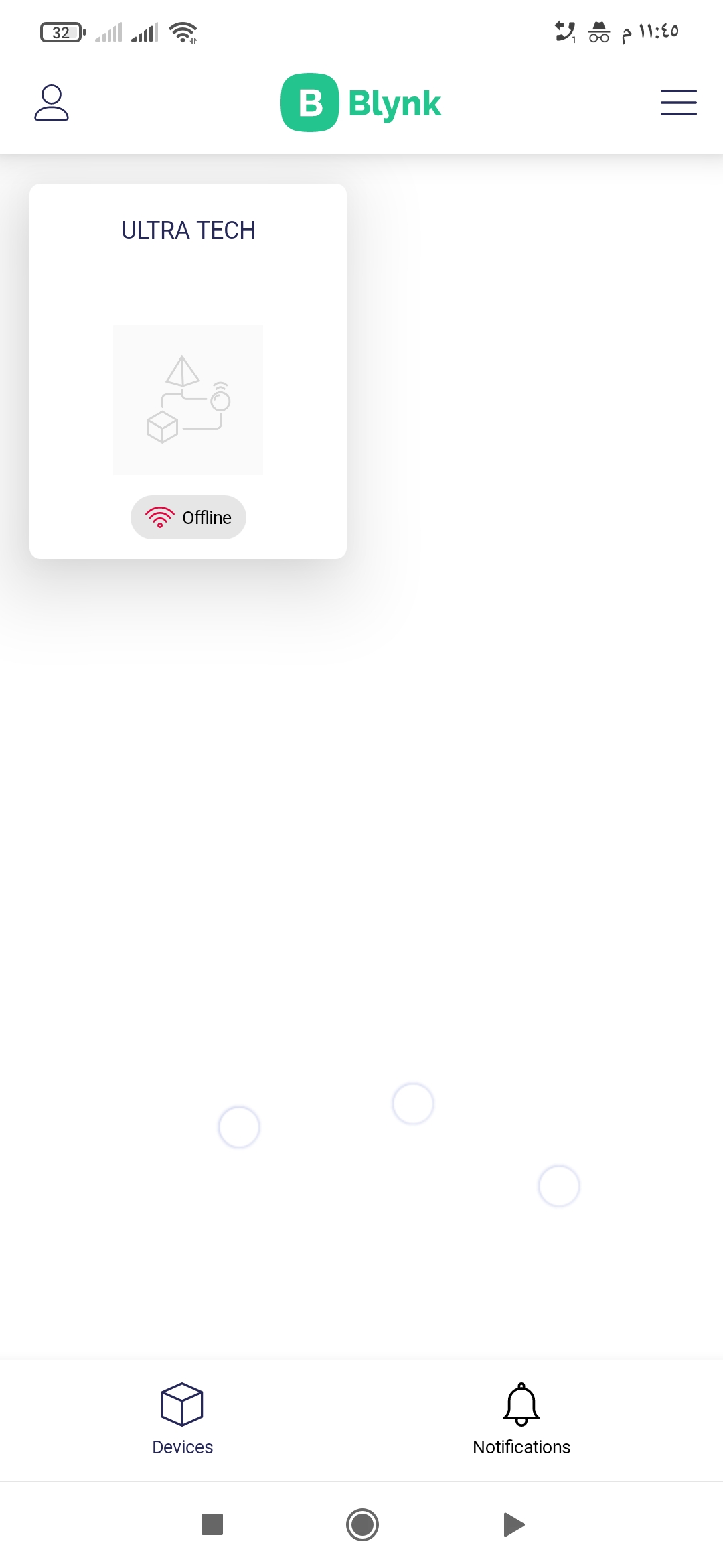

Here the device is present before I connect it to WiFi

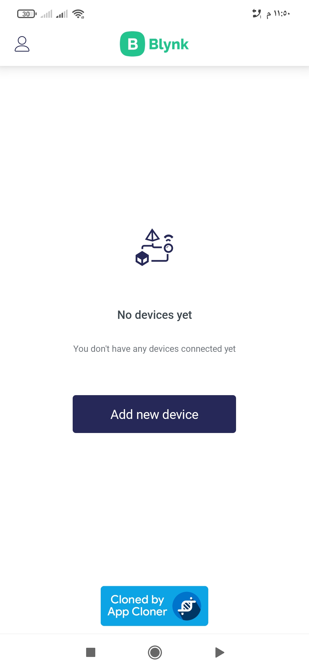

After I linked it it disappeared but it is in blynk consol
Looks template id doesn’t match the mobile tile template. How did you create the mobile template? Also, logs would be helpful.
