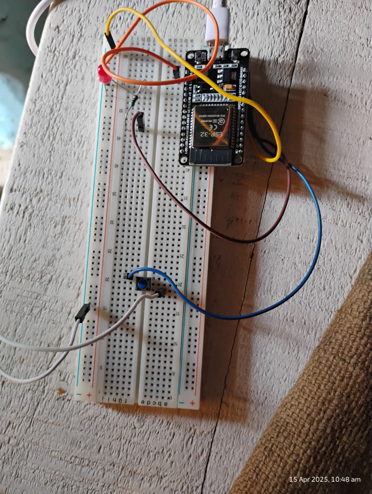

led is connected with D13 in series with a 220 ohm resistor
push button connection
one leg >-------D12
other leg>-----GND
the blynk button is in switch mode connected with data stream “integer VO[V0]
integer,0/255,id=2”
also one thing i noticed at first time when i turn on the light with blynk button then i turn off the light with the physical push button the the light turns off and also the blynk button state changes to off , after than the blynk app button does not respond to the state change of the physical button mean the synchronisation fails .i am also adding the circuit photo take a look
