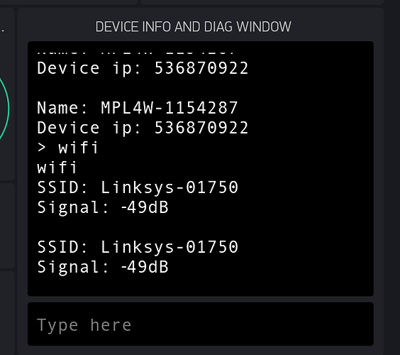

Updated Blynk on Android to the latest version. The project that was working well now has a problem in the Terminal Widget. Giving a text input, echoes the text 3 times and prints the output also three times.
I just updated and am not seeing any issue?? Mind you, I don’t use the terminal.***() commands I send all data with Blynk.virtualWrite(vPin, value)
I’ve used terminal.print, terminal.println and terminal.flush calls. New learning for me is that Blynk.virtualWrite() would work for terminal… Will try that.
Nevertheless, the issue with terminal.****() commands remain.
Yes, just seems to save a lot of hassle. Just a guess, but perhaps the terminal.****() commands are the older original way and left there for backward compatibility??
PS, if you want terminal.println() equivalent, just add \n to your string. And if you want to print \ just double it up \\.

Have to leave that one with the developers… who will see this eventually ![]()
Changed to Blynk.virtualWrite and problem solved.

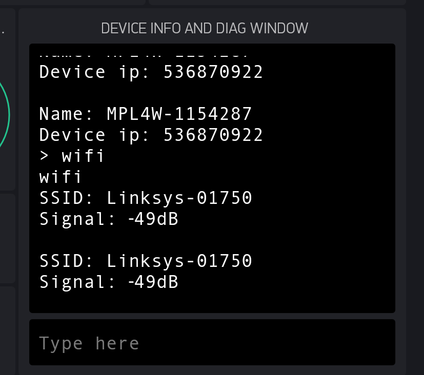

I thought my problem was solved! Comes up again even with blynk.virtualWrite.
Funny the keyed in command gets echoed once more. Does that provide a pointer? Was not happening earlier.
Which other widgets do you have in the project? And could you upload your sketch also?
Android 6.0.1MMB29M (Xiaomi MIUI Global 9.2). Have 5 buttons, 4 timers, RTC and a value display widget.

Not a scope of this issue, but why not use some loop here?
Sure could’ve. I’m not a coder and so did what came easy to me. Most coders will call what I’ve written cruft.
