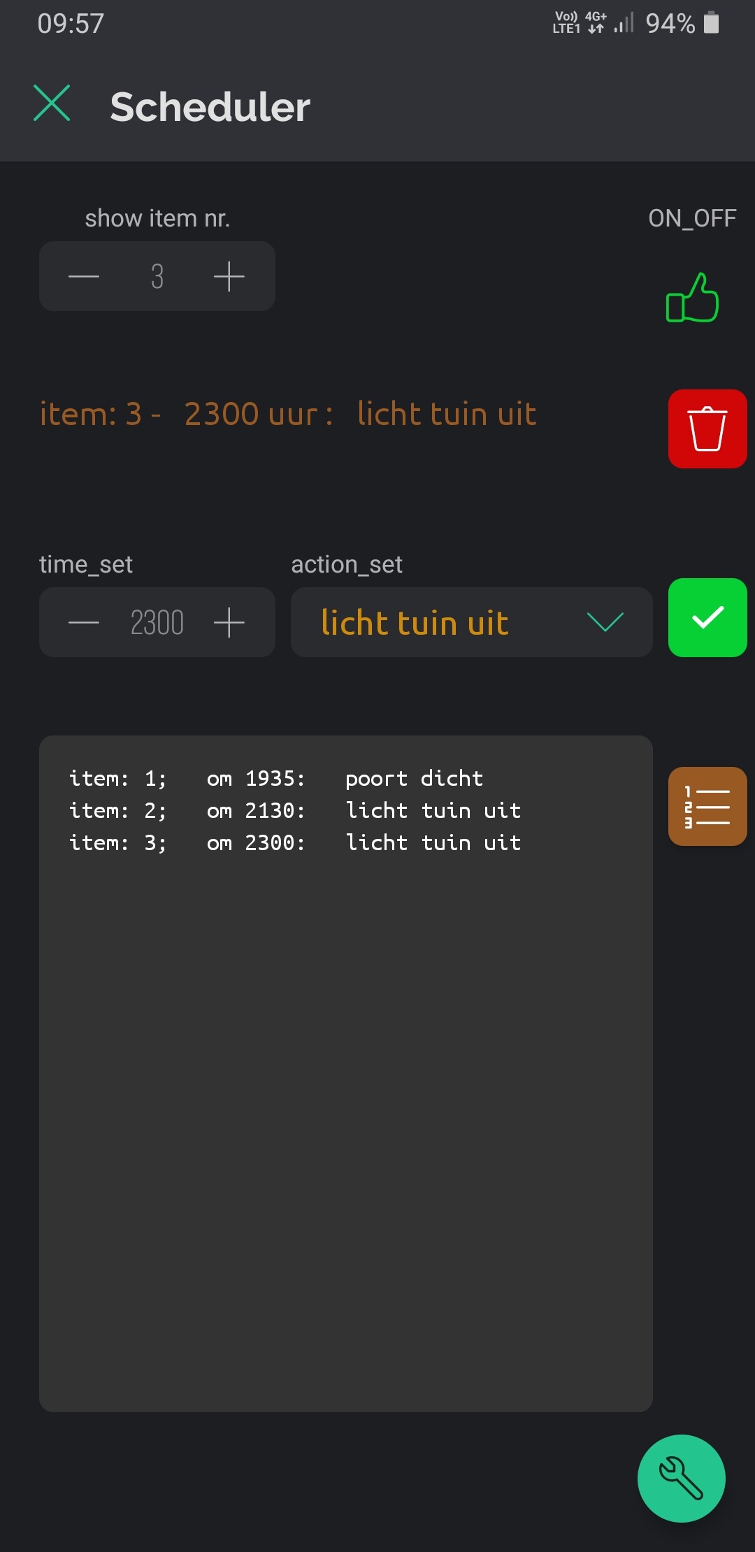

There are 3 messages on the screen.
After reopening the app, one would expect to see exactly the same 3 messages.

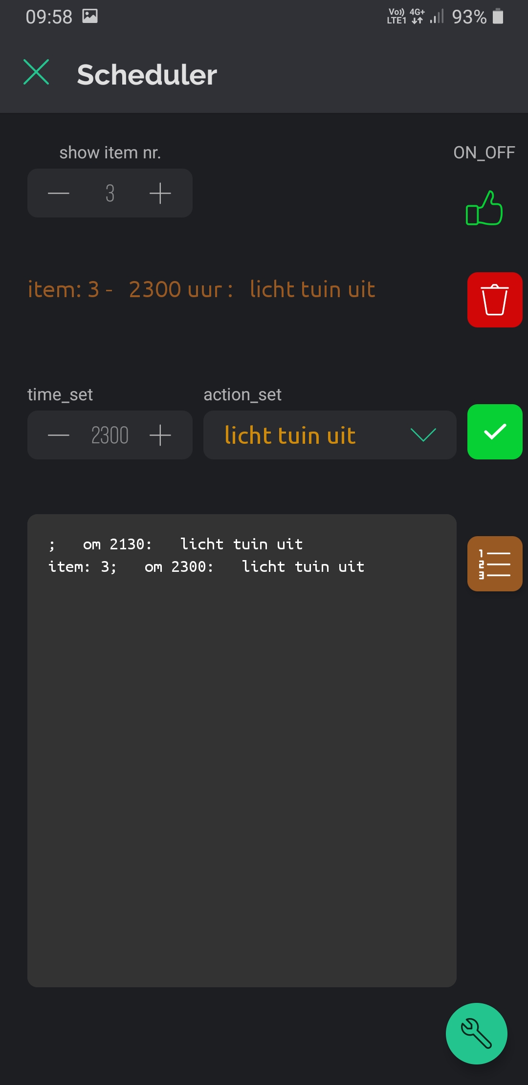

the current app versions shows the 3rd message correctly but the previous two are displayed and scrambled on the first line.

So here you are sending 6 messages, you can concat them by yourself and it will be 1 message
I was not expecting this to be 6 messages as it is one Blynk.virtualWrite after all.
Not sure I understand what you mean by “concat them by yourself”. How do I do that?

try this:
WidgetTerminal terminal(41);
and then print all bytes at once per line:
terminal.printf("item: %u; on %u: poort dicht\n", readpointer + 1, time1);
terminal.flush();
terminal.printf("item: %u; on %u: licht tuin uit\n", readpointer + 1, time1);
terminal.flush();
terminal.flush();
