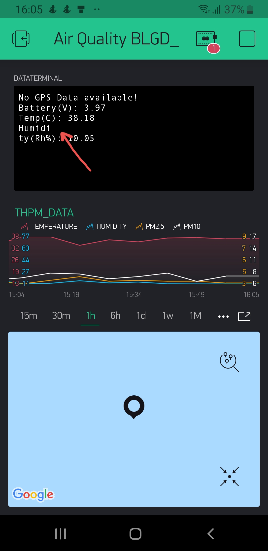

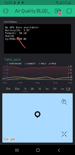

I am using the following:
terminal.println("Temperature: " + String(temp));
in a NodeMCU v3. As you can see in the image I get lines break and printed on a new line.
and the temperature at least is displaying one one line…

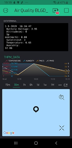

I just used a simple line, but braking seems to happened in certain quantity of letters. The whole terminal printing section is as follows:
terminal.clear();
terminal.print(String(gps.date.day())+'-'+String(gps.date.month())+'-'+String(gps.date.year()));
terminal.print(" ");
terminal.println(String(gps.time.hour())+':'+String(gps.time.minute())+':'+String(gps.time.second()));
terminal.println(" Battery Voltage: "+String(vin));
terminal.println(" Altitude(m): "+String(GPSAltitude));
terminal.println(" Speed(km/h): "+String(windSpeed));
terminal.println(" Satelites#: "+String(satelites_count));
if (celsTemp > 200) { terminal.println(" T/H: Error!"); }
else {
terminal.println(" Temperature: "+String(celsTemp));
terminal.println(" Humidity: "+String(humidity));
terminal.flush();
I thought that println method just cuts the line and positions the marker at the begging of the next line. It appears the widged terminal.println it is not functioning the same way as Serial.println

It doesn’t matter to anything I have done. The line breaks on the 58th symbol. So thru 57 it is all good, on the 58 goes automatically on a new line NO MATTER WHAT.

Sounds like a buffer issue… try sending less before the terminal.flush() command.

The Terminal widget println method has issue. It prints line, but after the 57th symbol cuts the line automatically and starts from the next row.
If you do flush before that part(the 57th symbol), it leaves an empty row between the printed lines.
