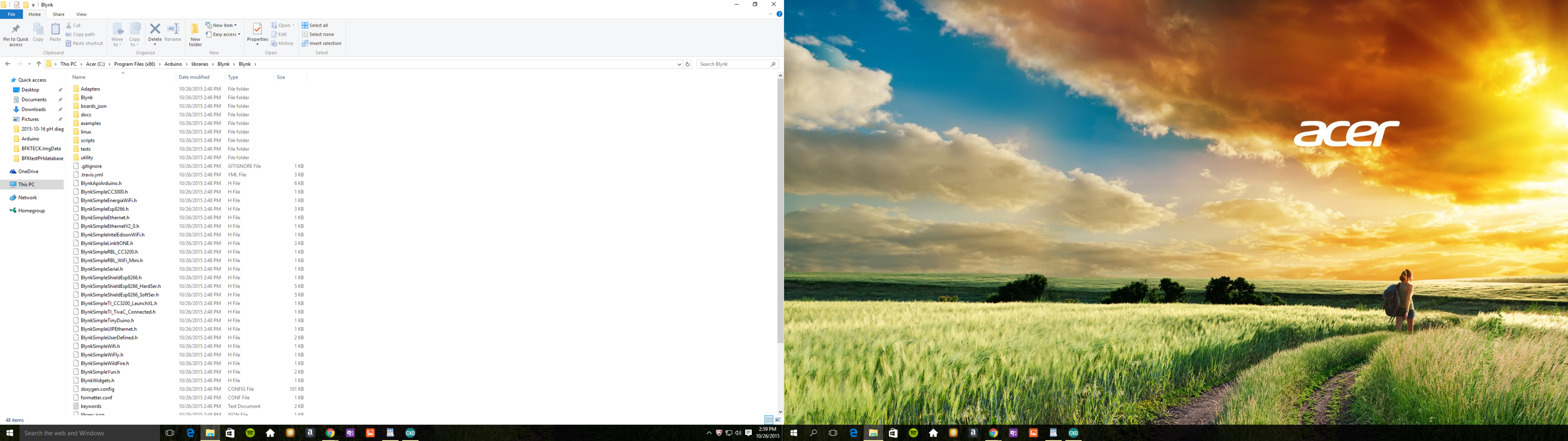

Here is a screen shot of my library folder
I am sure it is something simple that I am missing/doing wrong. Thanks for the help
It seems that you don’t follow the instructions from https://github.com/blynkkk/blynk-library/releases
The structure should look like this:
~\Arduino\libraries\Blynk
~\Arduino\libraries\BlynkESP8266_HardSer
~\Arduino\libraries\BlynkESP8266_SoftSer
~\Arduino\libraries\SimpleTimer

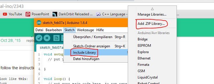

Hello. I had integrate the libraries like in the description, nevertheless it doesn’t work. But If you integrate the entire libraries as a .zip data, it will work.
