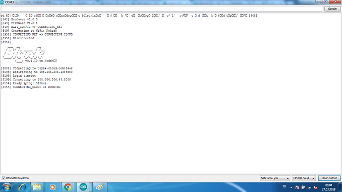

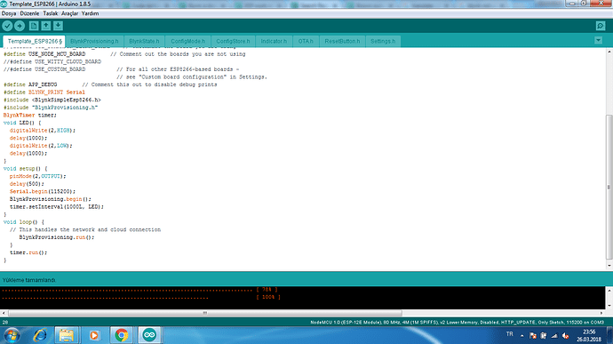

simple led burning example is not working offline. The code is not working when there is a power failure or network failure. I’m waiting for your help. Thank you.
Posting screenshots of portions of your code isn’t really the best way to share your code.

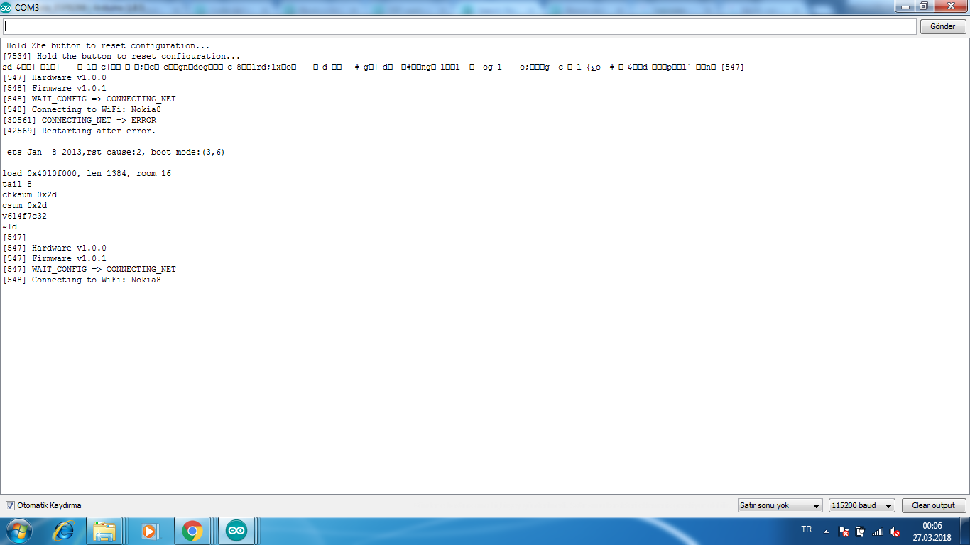

You’re using Blynk provisioning, so presumably (I can’t see your whole code, so can’t be sure), when your Wi-Fi is down and your device can’t connect it goes into Access Point mode so that you can input fresh Wi-Fi credentials. Without a time-out on this, and on any blocking Blynk.begin or Blynk.connect code that follows the provisioning routine, the rest of your code won’t run.
If you search the forum for non-blocking Wi-Fi topics you’ll find some pointers to help you understand how you need to change your code.
