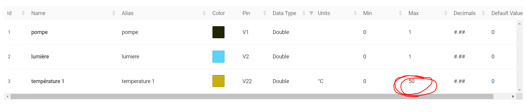

- Unable to import the value of my temperature sensor
- My widget button works well on mobile application, on the other hand impossible to make them work on WEB DASBOARD.

Blynk.virtualWrite(i + 21, tempC);
