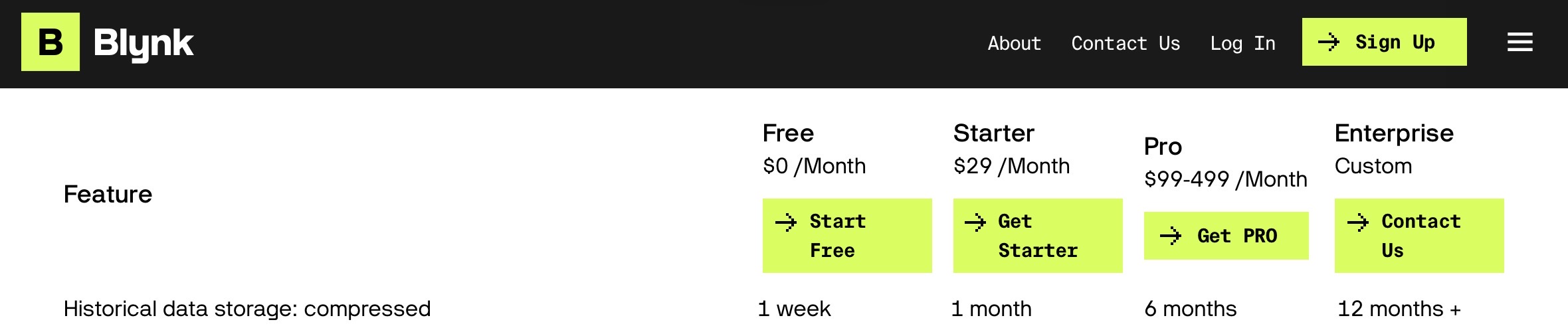

I am using Blynk platform from Feb 2023 free plan and i need data from 2023 to current , i want to upgrade plan from free to starter , is it possible to retrieve data in CSV file against virtual pins having enabled history data at cloud ??
The Starter plan only gives 1 month of data storage, so to view the desired 3 years of data you would need to be on the Enterprise p,an.
Data will start to be retained from the period when you sign-up to the new plan, it won’t give you access to historic data because that data just isn’t stored for the lower cost plans.
