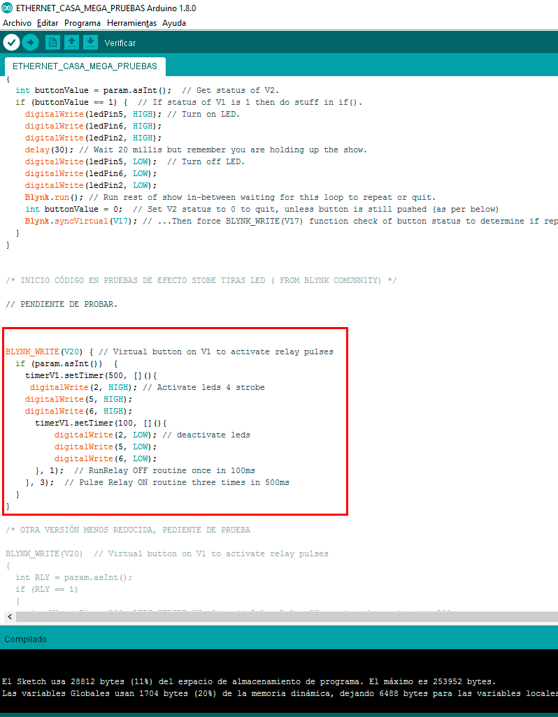

I have several led strips that I currently control with Blynk.
Now I’m trying to go further, and make them do the strobe effect with a virtual pin.
I have used the Simple Timer library to switch the led strips state with a push button, and I was thinking if it could be possible to use this same library for doing this.
Thank You.

I recently did something similar with pulsing a relay. Try this concept: Producing pulses Just adjust the times and flash the LEDS instead of the relay.
// Non-blocking pulse routine every 500ms for three times, leaving the relay activated for 100ms each time.
BLYNK_WRITE(V1)  // Virtual button on V1 to activate relay pulses
  int RLY = param.asInt();
  if (RLY == 1)
    timerV1.setTimer(500, RelayON, 3);  // Pulse Relay ON routine three times in 500ms
void RelayON()
  digitalWrite(2, HIGH); // Activate relay
  timerV1.setTimer(100, RelayOFF, 1);  // RunRelay OFF routine once in 100ms
void RelayOFF()
  digitalWrite(2, LOW); // deactivate relay
  if (RLY == 1)
void RelayON()
void RelayOFF()
let update this a bit…
BLYNK_WRITE(V1) { // Virtual button on V1 to activate relay pulses
  if (param.asInt())  {
    timerV1.setTimer(500, [](){
      timerV1.setTimer(100, [](){
      }, 1);  // RunRelay OFF routine once in 100ms
    }, 3);  // Pulse Relay ON routine three times in 500ms
Sooo nice and compact… but now I can’t understand it :wink:
My “discovery” (more like tripping over a rock while banging sticks together) has created a coding monster :smiley:
You actually have no idea… I spent a good 2 days updating ALL the codes to the new format!! :joy::heart_eyes:
I’ll check it.
Thank You so much!.
It looks pretty well,
I try that code tomorrow, because it’s for an Arduino shield that I don’t have here.
I’ll tell you something :slight_smile:
Thank you very much.
By now I have just implemented it into my code.
