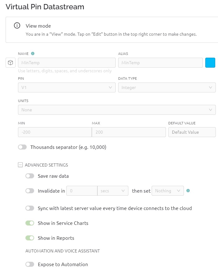

I’m trying to run pretty simple tempperature measurement project and I’m really struggling with reading the proper value from Blynk virtual pin after Wemos D1 restart. I’d expect the following steps to be taken:
1 Start the MCU and initiate Blynk connection
2 Synchronize V1 pin
3 Assign V1 pin value to MinTemp variable
4 If MinTemp is equal to -127 (i.e. temp sensor was disconnected) then assign dummy value of 99 to MinTemp variable to allow proper min() calculation
5 Blynk connection completed
6 Set Blynk timer for periodic temperature measurement and upload
7 Check MinTemp value before temp measurement
8 Check MinTemp value before temp measurement
Unfortunately I’m facing strange behaviour: once ESP8266 was started, the MinTemp variable value read from Blynk server in BLYNK_WRITE(V1) routine is correct but then two lines down, once the code entered ‘if’ loop, the value changes to -127, see the serial monitor output below:

Any help or tips how to identify/fix the issue would be appreciated.
