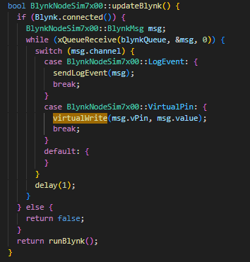

For the devices with the webhook we are having an issue with we use the Blynk library on the device.
PS, FYI I have other webhooks running without issues, but for these we communicate via MQTT to blynk…
When a value on the device changes we store this in a queue, when connected we run below method every 1 second:
calling virtualWrite(…) within the blynk library
and as an addition, we only read the kWh meter every 61 seconds and the toggling is much faster
