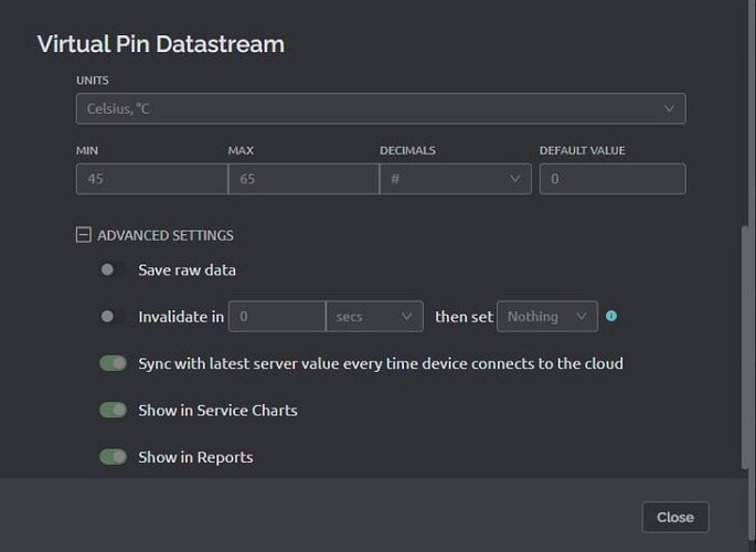

Do you have any data invalidation rules set-up in the datastream advanced settings.

If I understand your question correctly, the answer is no. I provide a screenshot:
No.
