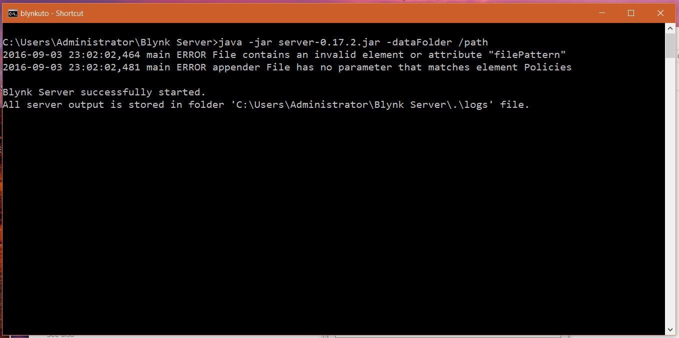

Maybe this is the error? i dont know?

@Zam08 I don’t really know what your problem is but you shouldn’t be running the java command with /path at the end.
You need to be entering the actual path to your data directory, so maybe
/Users/Administrator/Blynk Server/data
in your case as the path format appears to be unix style even on Windows machines.
You might want to change the name of the Directory from Blynk Server to BlynkServer,
I just updated build. Please download file again.
So okay… ill remove the /path in the java command and change the “Blynk Server” to “BlynkServer” right?? Thank you!
Even though you are running Windows I would lose the space and enter your directory path to the data directory at the end of the java command line instead of /path.
