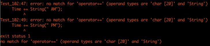

I’ve churned through the forum for an answer to what I’m sure is a simple solutions, but I can’t find it. I’ve come close with @JoeS but can’t make it work .
Using WidgetRTC and the default code provided by @vshymanskyy how do you convert military time into a standard 12hr format with the AM, PM displayed??? Do I use hour12() inplace of hour() ? If so, how do you get the AM PM, isAM() or isPM()? Are these just True/False statements?
THANKS IN ADVANCE !

Ya, @Gunner, I get the math! Thanks for pointing it out. At the end of the day this whole forum could be replaced with Google searches. Just to be fair I followed your link provided. It was a useless link. If you don’t know the answer to a simple question to help out other Blinkers on a topic under the heading "Need Help With My Project", maybe you should just pass. Again… maybe someday we’ll all know everything about Blynk, C++. Until that day comes, I’d still appreciate constructive advice.
You are closer to the mark then you think on that one This is a Blynk forum, but many of the questions ARE NOT Blynk related… that does muddy up the waters for those who have Blynk specific issues.
@Jamin, I’ll go back and review those pages again. I’ve looked through them at length prior to this post and didn’t understand the integration into the code.
Good example @Jamin Thank Heavens for bad beach days (once in awhile ;))
Syntax beats my hacked math method… I think it messes up on 0:00 hours… but then I wasn’t really doing any research as I prefer the military time (keeps me thinking) and I didn’t feel like being a code monkey today
void clockDisplay()
int HOUR = hour();
if ( HOUR > 12 ) {
HOUR = HOUR - 12;
String currentTime = String(HOUR) + ":" + minute() + ":" + second() + " PM";
Blynk.virtualWrite(V12, currentTime); // Send PM time to the App
} else {
String currentTime = String(hour()) + ":" + minute() + ":" + second() + " AM"; ;
Blynk.virtualWrite(V12, currentTime); // Send AM time to the App
String currentDate = String(month()) + " " + day() + " " + year();
Blynk.virtualWrite(V13, currentDate); // Send date to the App
You are speaking to a total amateur coder here as well… and while I do appreciate examples to glean from, I still rely HEAVILY on Google and Arduino - Home and try to only ask Blynk specific questions now (except when I am begging for Linux help… then I whimper like a baby ;P)
