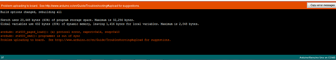

hi,
i cant upload blynk exampls in my uno rduino.i have w5100 shield. this is my problem

Try removing the usb cable and reconnecting it.
sorna
May 8, 2016, 10:53am
3
i do it .but dosent work.
arduino suggestion me using proxy direct.
what this means?
i dont no what i should do

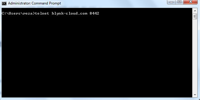

Please read instructions here http://docs.blynk.cc/#troubleshooting
telnet blynk-cloud.com 8442 from
sorna
May 8, 2016, 10:42pm
17
this mean i open cmd and type this ?
sorna
May 9, 2016, 9:59am
18
i do that
but i did not see : Connected to blynk-cloud.com.
how can solve this problem.
thanks for helping
