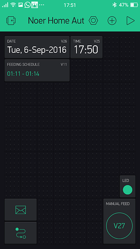

As you can see in my Android Screenshot below, V11 is a Time Input Widget,

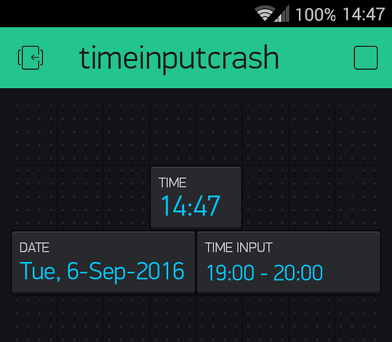

So [0] start seconds, [1] stop seconds and [2] gmt offset seconds are ok but not the others (whatever they are).
@noersaleh Looking in WidgetTimeInput.h [3] is weekdays and the following line is ok as long as at least one trigger day is chosen in Time Input.
Serial.println(param[3].asInt()); // this gives first day of the week chosen as trigger
Now: 1473172071
Date: Tue, 6-Sep-2016 ---- 14:27
57600
61200
10800
4
Now: 1473172091
Date: Tue, 6-Sep-2016 ---- 14:28
but I think you really need the advanced example if you want access to the weekdays.

Oh Ok, so Time Input always giving me the UTC value … So have to adjust in my sketch to refer back to GMT+7
Its considered solved …
Appreciated with all of your support … (and Costas too …) :slight_smile:
