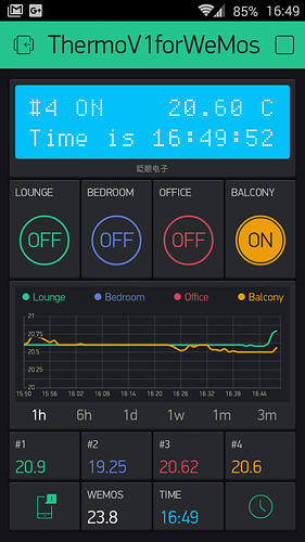

Screenshot below of the RTC working ok with ESP-01 and WeMos D1 Mini.
We had to make an adjustment from GMT to local time in our sketch.

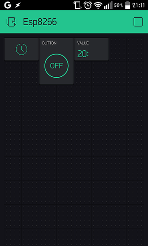

I’m trying to show the time using the “Value display” widget (v0) and I’m doing something wrong…
this is the piece of code:
Blynk.virtualWrite(0,hour(),":",minute());
At the app side I see this:
What am I doing wrong? It should be something really silly…:confused:
Thanks for this widget!!! This is something really useful!!
Regards
@psoro the 20 is because you are 1 hour ahead of GMT in your location, which is 21 hours.
Quite messy code but this is what we did:
  int gmthour = hour() + 2;
  if (gmthour == 24){
     gmthour = 0;
  String displayhour =   String(gmthour, DEC);
  int hourdigits = displayhour.length();
  if(hourdigits == 1){
    displayhour = "0" + displayhour;
  String displayminute = String(minute(), DEC);
  int minutedigits = displayminute.length();
  if(minutedigits == 1){
    displayminute = "0" + displayminute;
  String displaysecond = String(second(), DEC);
  int seconddigits = displaysecond.length();
  if(seconddigits == 1){
    displaysecond = "0" + displaysecond;
  String displaycurrenttime = displayhour + ":" + displayminute;
  String currenttime = "Time is " + displayhour + ":" + displayminute + ":" + displaysecond;
  Serial.println(currenttime);
  lcd.print(0, 1, currenttime);
  Blynk.virtualWrite(V11, displaycurrenttime);
LCD showing hours, minutes and seconds, Value Display just hours and minutes.

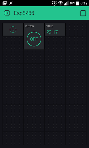

you should create a string with results from RTC widget and only then push it to the Virtual Pin of Value Display.
So my messy code was necessary based on string @Pavlo.
Thanks @Costas and @Pavlo!
Now it looks much better!! The trick was the string as you said.
I’ll adjust the hour for my location with a bit of code, no worries.
Thanks again!!
