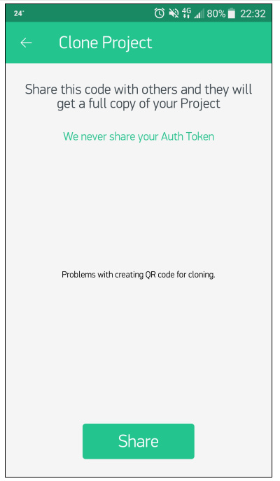

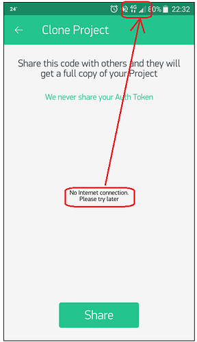

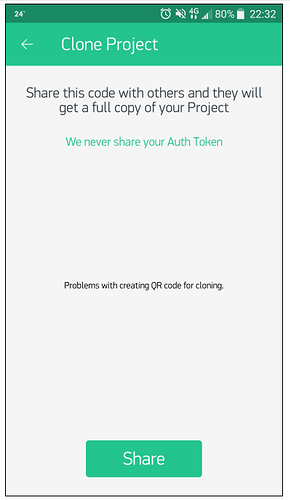

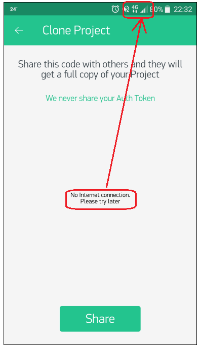

Hi Blynkers,
I tried to clone a project and the result is an empty QR with a message “Problems with creating QR code for cloning” or “No internet connection. Please try later”
For sure my connection is up and running…

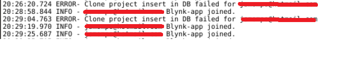

That’s correct. For local server the clonning not yet supported (requires DB).
@BlynkAndroidDev I’ll fix that. No actions from your side required.
Ticket created - https://github.com/blynkkk/blynk-server/issues/749
Understood, thanks to both for the fast reply, please, let us know after you fix it.
Regards!
I should pay more attention to the Blynk.log file…:sweat_smile::
