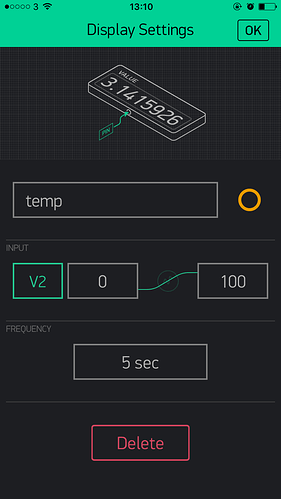

Thanks for the quick response. I tried your code and it runs fine, but I still don’t see any data in the App. The default blynk debug doesn’t show much so I don’t know if the requests are received correctly.
I’ve set up the App like this and tried different timers but nothing.
Thanks,
J
