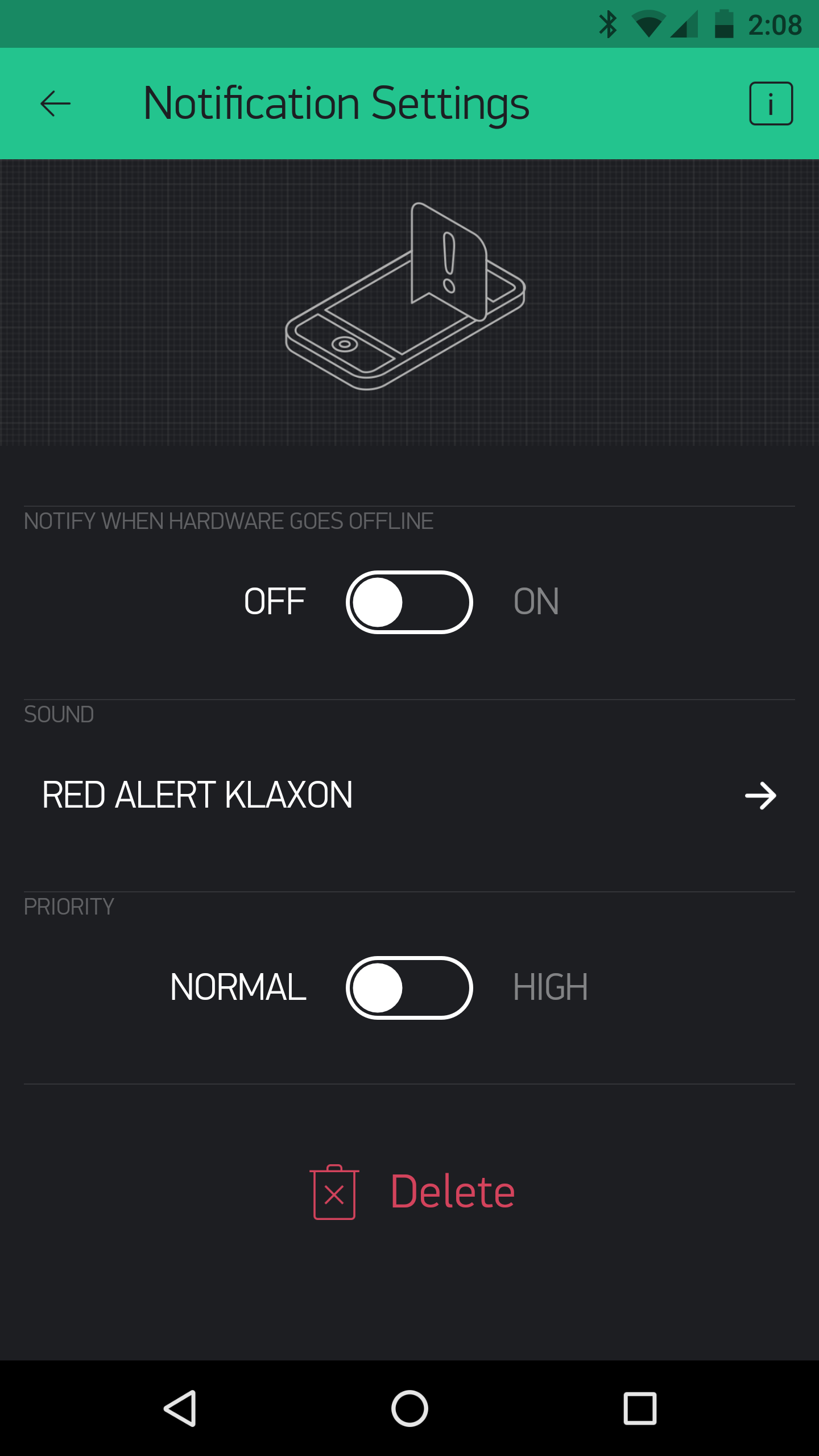

@Steve-K Discussion aside… Have you actually tried push notifications with a custom ringtone for yourself?
I have one - My Star Trek “Red Alert”, that is very loud and plays for about 15+ seconds. When triggered from my MCU, even with my phone “sleeping” and Blynk only in background, the alarm notification goes off and it displays the notification onscreen. And when I click on the notification, it stops the alert and opens the associated Project. And as I already mentioned, it is very easy to make that a repeatable alert.
