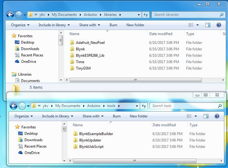

Getting the below error after compile.
Anyone familiar with it ?
Looks like you incorrectly installed the libraries. Read the guide again.
I did it again from beginning.
No success.
Remove all previous installations + you might have installed Cayenne library that breaks things. Remove that as well.
You seem to have taken it too literally. Paste the contents of libraries and tools into the existing directories of the same name that you should have on your system, don’t copy the directories into the existing directories.
Still the same compiler error?
Have you ever installed the Blynk clone called Cayenne?
Have you restarted the Arduino IDE since installing the libraries?
Thank you. Now is better. I moved these folders one level up. Near the Arduino folder was another one libraries folder.
