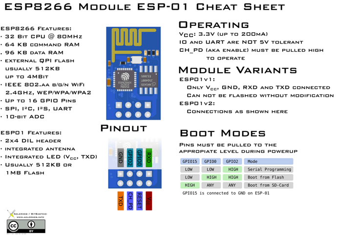

so you did connect RX and TX properly tied GPIO0 to LOW, CH_PD to HIGH and GPIO2 to HIGH?
So true, I messed up a couple of them bigtime, lol.
Also, as @conkerkh notices, put the right pins high. I think even RST should be high when running/flashing.
OP appears to have had success with other ESP8266 modules so i was assuming the basic wiring was not the problem…
e.g.
yes, i am usually RX & TX wrong, but i’ve never burned one… does the smoke escape, or do they just stop working?
Usually they stop working. There is not much smoke in these little guys and they are pretty resillient. I used 5v logic on them a couple times, but that eventually does the trick, lmao.

First of all other modules have different wiring in terms of some pull up or pull downs might be missing. Secondly don’t be so sure you didn’t make mistake doing wiring even if you do it 1000 times you can make mistake…
If ESP is dead it always gets very hot quickly so it’s easy to identify it you burned it.
