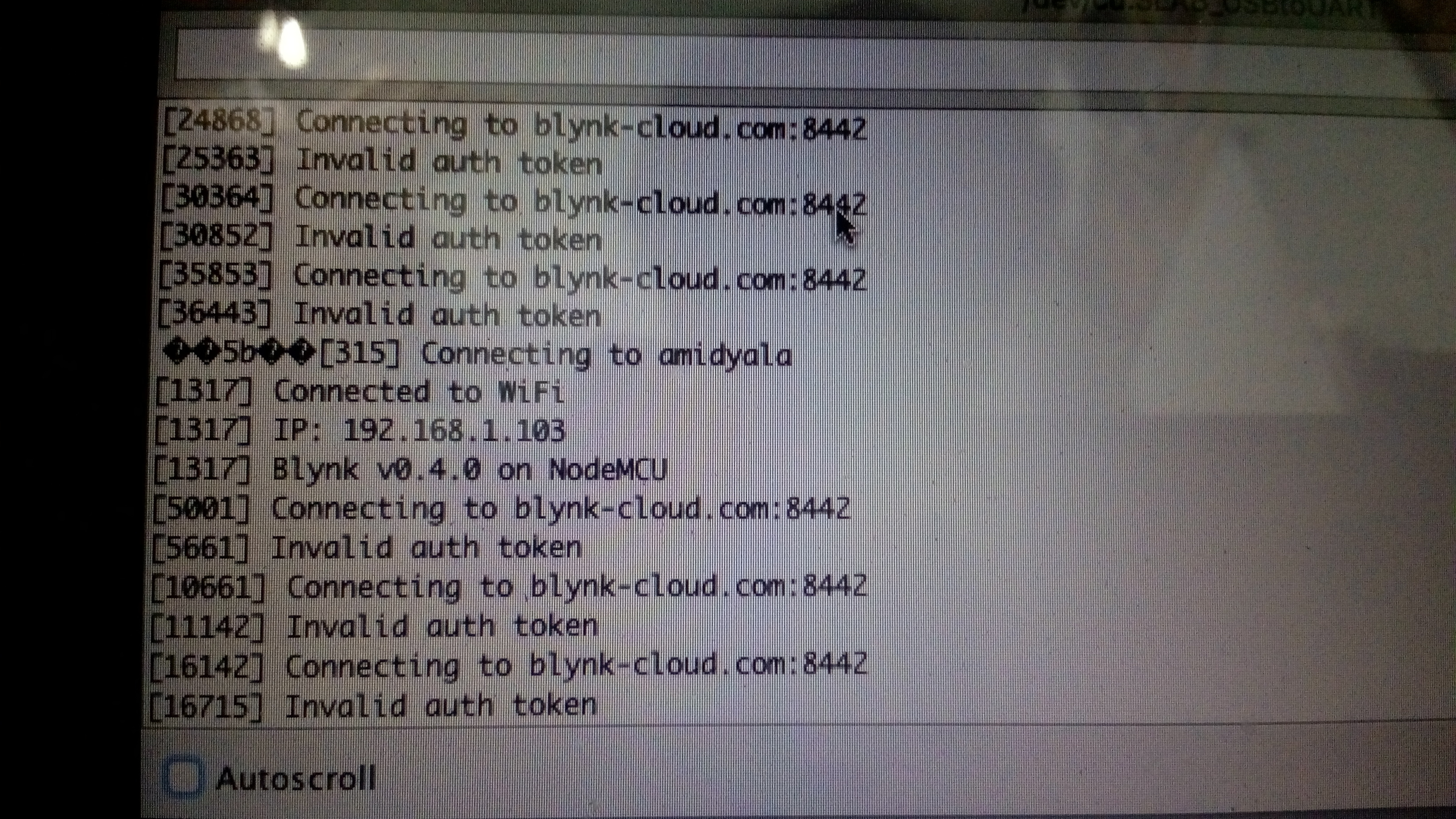

I%��=s��[315] Connecting to amidyala
[1317] Connected to WiFi
[1317] IP: 192.168.1.104
[1317] Blynk v0.4.0 on NodeMCU
[5001] Connecting to blynk-cloud.com:8442
[5856] Invalid auth token
so what could be the solution for that?
This means the auth token is not valid. Maybe you have made a typo?

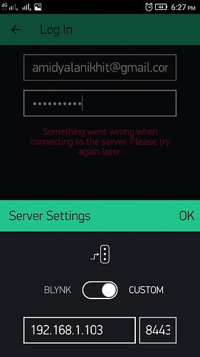

@nikky it could be http://docs.blynk.cc/#troubleshooting-geo-dns-problem. Try to ping blynk-cloud.com from your home. Take IP and put it in app as described in link above. Please let me know if that helps.

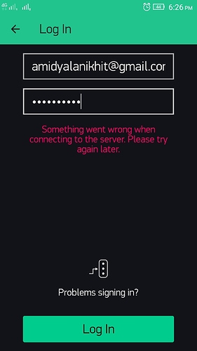

i did step as per the above doc but it was not solved this r the screen shots of my phone
this message appear when i use mobile data on andriod phone to connect to blynk server
you need to ping blynk-cloud.com and take it IP.
ya actually i did it i enterted the ip which is displayed in the serial monitor but when i log in to app “something wrong happen msg” is being displayed
