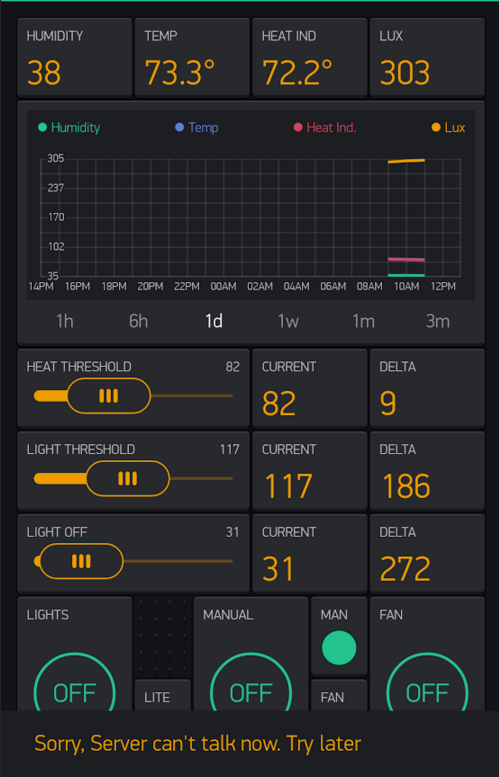

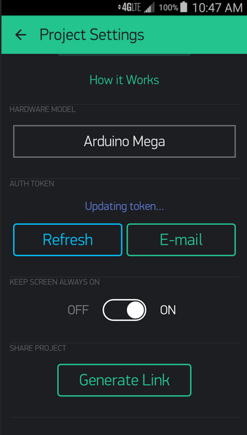

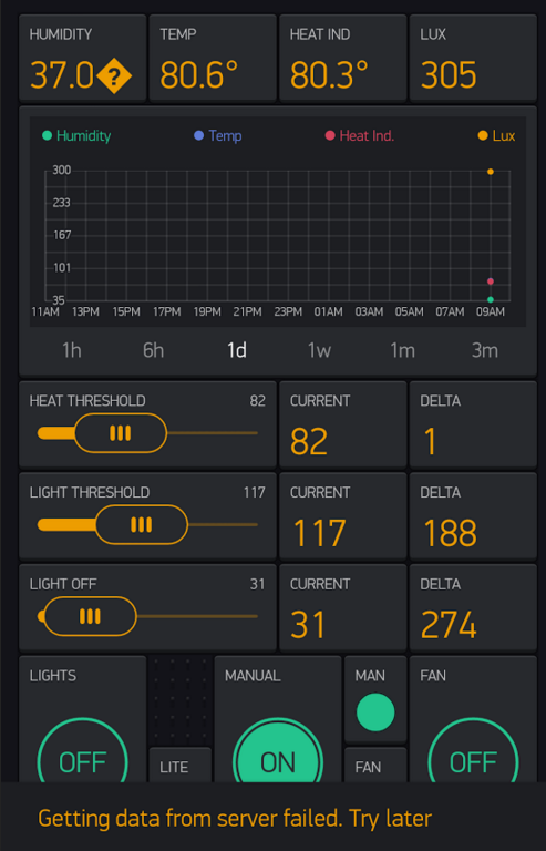

sorry if the code isn’t up to par, this is my first time programming an arduino, and has been a huge learning experience.
Thanks for helping!
also note that I am writing special characters back to blynk, specifically the % sign and degree symbol ° .
