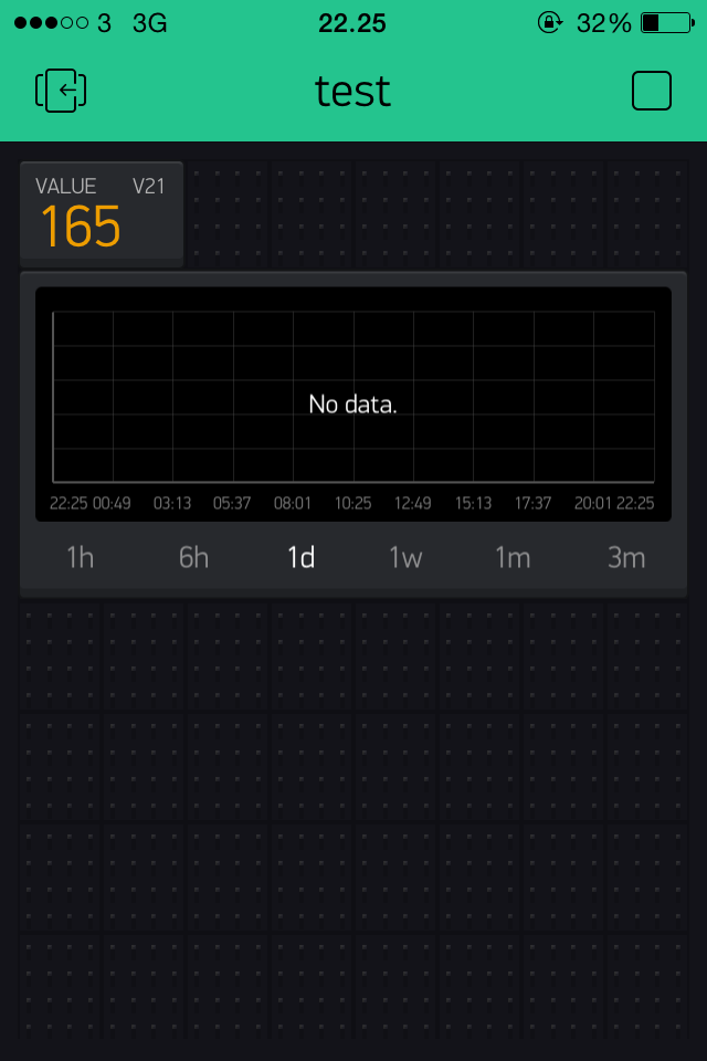

what wrong this my sketh?
dont display history graph
no data
check my sketch

thank’s min
You could change 21 to V21, I’m not sure it matters, but just to be sure :smile:
result same
have your solution?
skecth solar cell right?
1d updated once per hour.
1h, 6h - updated once per minute.
how to make sketch 1d,6h?
You don’t need to do anything. Just click on “1h” label on graph :wink:
thank’s min this work :slight_smile:
