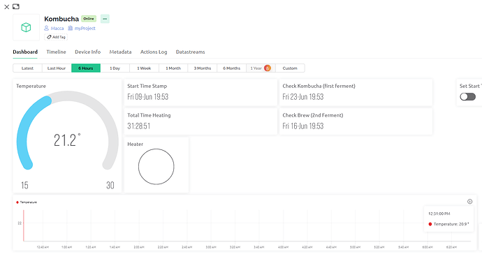

Short term Dashboard history has stopped updating and is blank

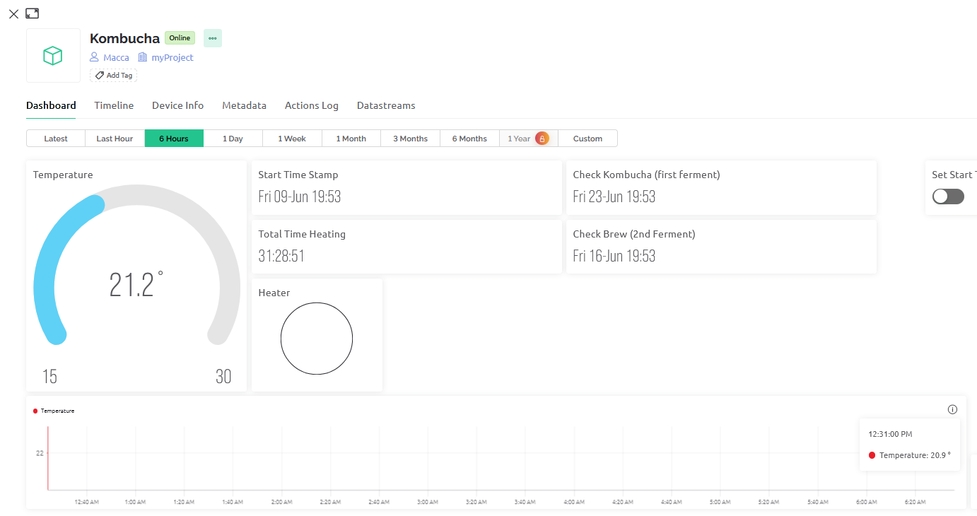

I have a temperature graph running on my Kombucha brew chamber and it was displaying fine the last hour and 6 hours but now it’s blank?

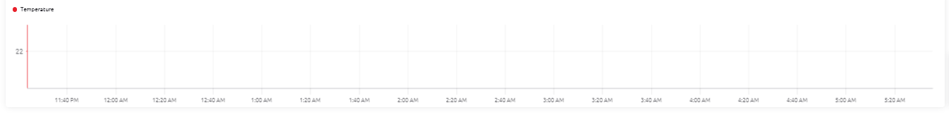

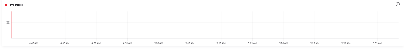

One hour
Six hours

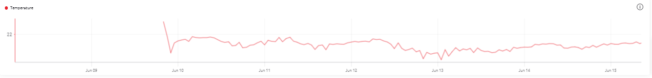

One Day
One Week

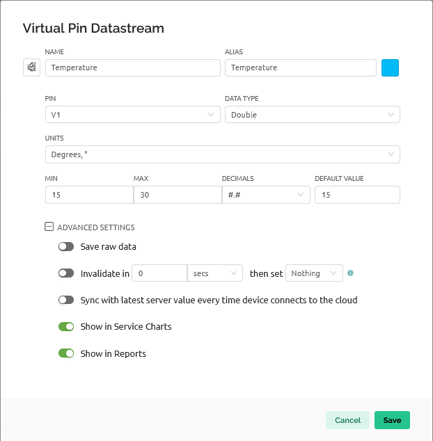

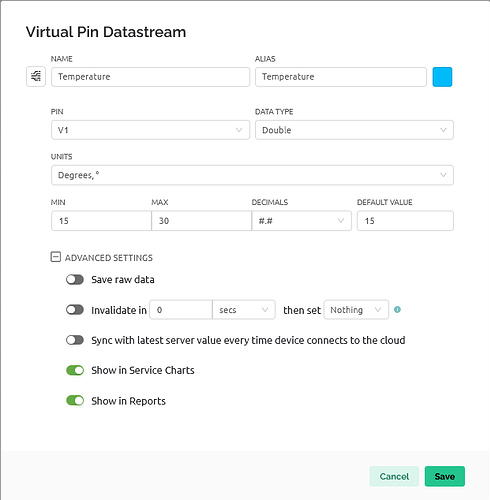

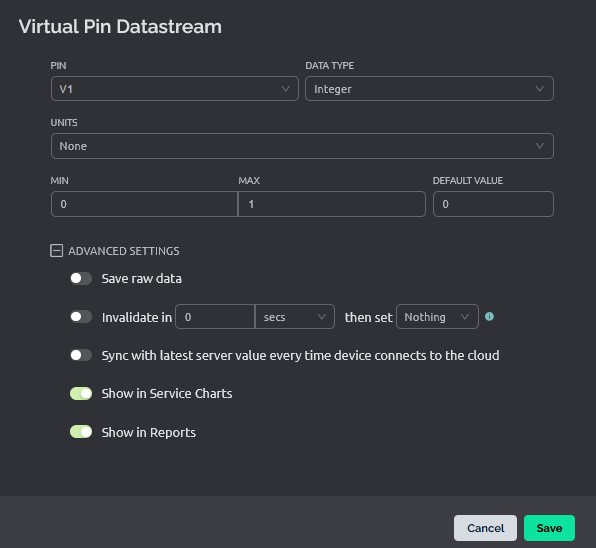

Hello, @macca . What are your datastream settings?
Thanks for the reply @Oleksii-QA

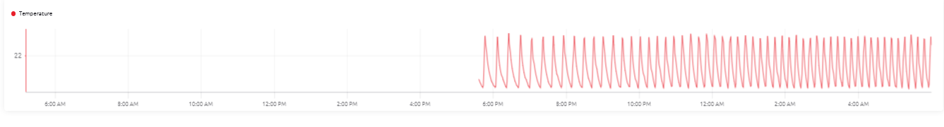

All my streams are just default and it’s all been working fine for the first week till yesterday at UTC 17:35
Plus @Oleksii-QA if I hover over the timeline you get a reading at the end of it like this

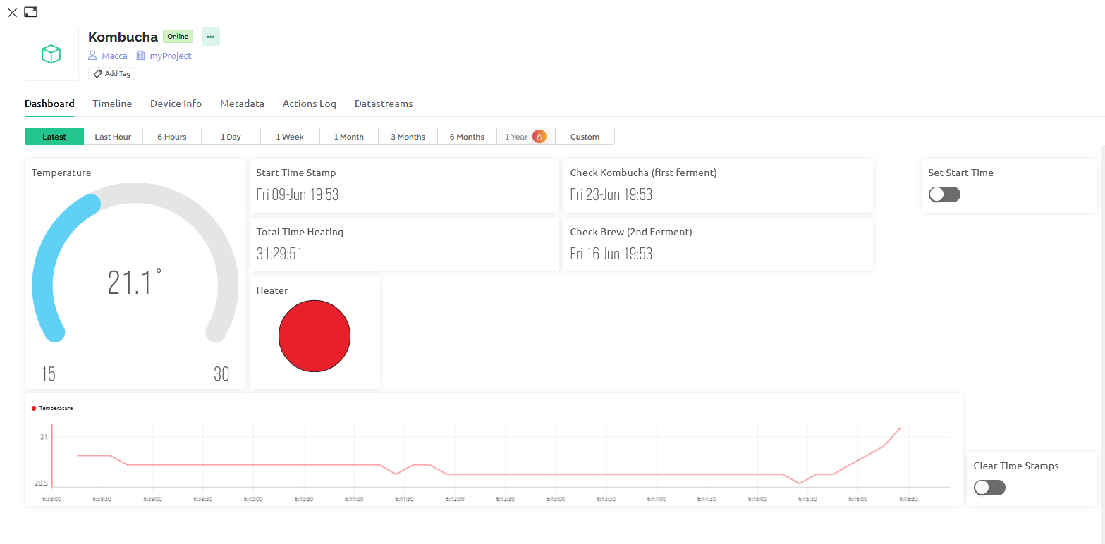

for completeness, Latest graphing seems to work fine
Sorry @Oleksii-QA I have found the problem.
Somehow my PC clock was two days behind.
I think it screwed up when it did a Windows update 2 days ago.
It’'s all working fine now the clock has been updated.
