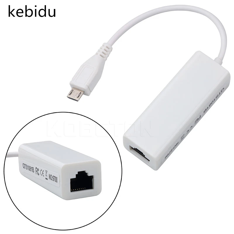

I have ordered a couple of these for the Zero W in any case:
