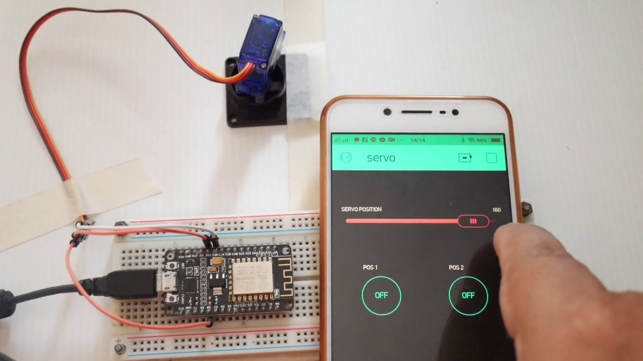

So i go to youtube and found a guy that explain how to control a servo motor.
i copied his code and did exactly what he said and no changes at all, the servo just keep spinning and spinning…

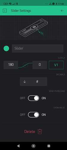

Then, post your code, details of your hardware and connections, what you see in your serial monitor, what widgets you have set-up in your app and how they are configured, and details of EXACTLY what happens when you boot your device and when you operate the widget buttons.

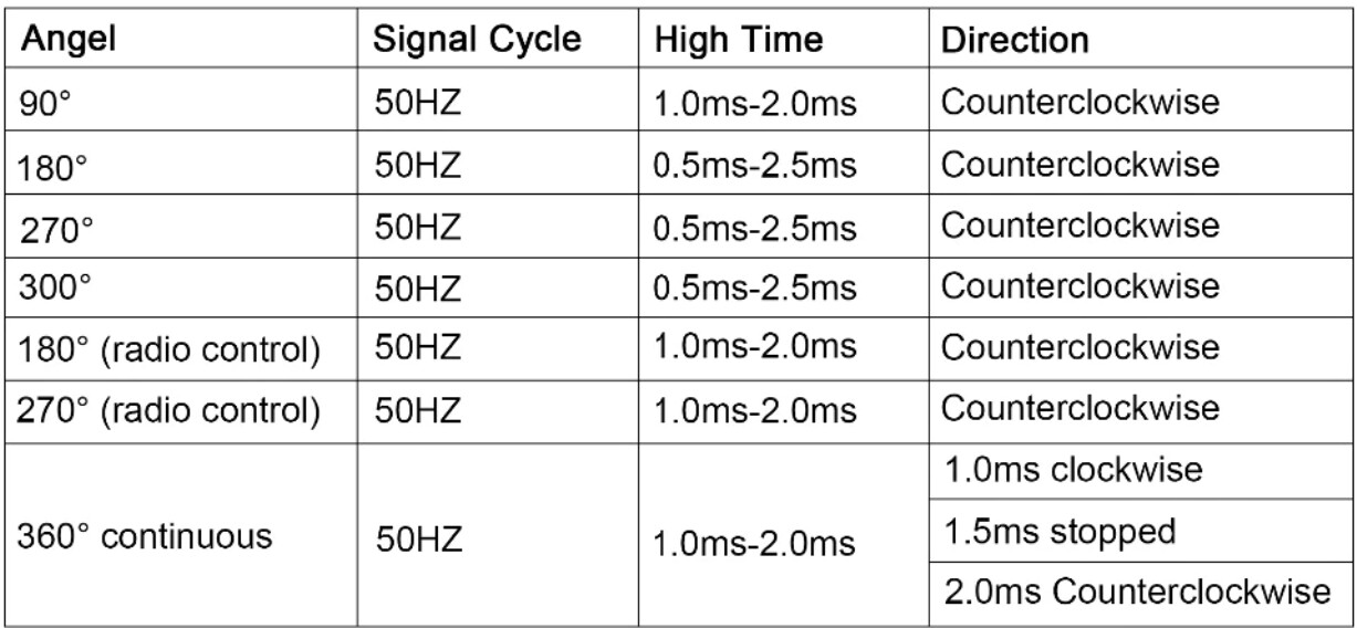

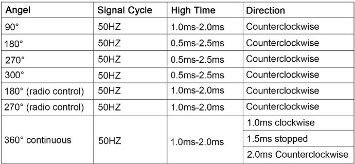

ok i have some “good news” i tried a different code and now instead of choosing the angle I’m choosing the speed of the spin/ i make a slider 1-180, when 1 is the fastest spin clockwise and 90 the servo stop, 180 full speed in anticlockwise. the servo isnt stopping!!! in the video the servo stop!! maybe something changed in blynk setting through time? or what?
im using a 360 servo 30kg, and i think that this is the problam?
