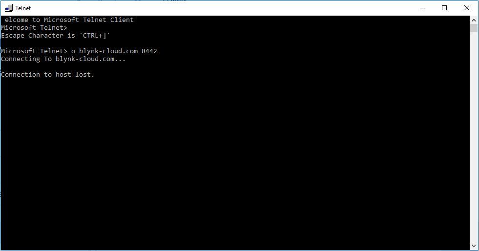

I get the following:
If it is port blocking causing this, how do I unblock it? Or am I doing this test wrongly?
o blynk-cloud.com 8442
It starts connecting, then says ā€˜press any key to continue’. I press space bar, wait a while and nothing happens. Then press space bar again and shows the following:
That is what you should get with telnet as you are not providing a token. Have you also tried it with the IP address? Looks ok so you probably have another problem.
