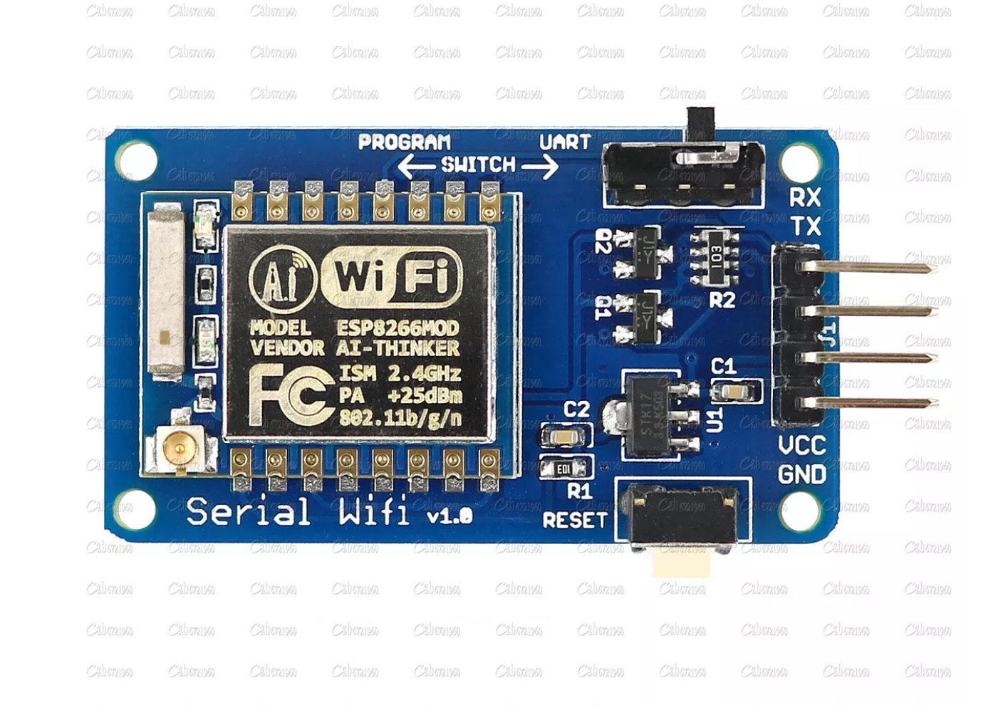

Oh, okay, I understand. But the current esp module I own, is actually not a shield, but a esp communicating using just Serial commands. So I wont be able to upload code to it, I guess?
Commonly known as an ESP07.
