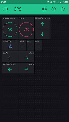

Hi, I make project with my esp8266, pir sensor and YX5300 module (mp3 player with uart). In my projekt I want make led strip remote control on wifi, and I tray attache somthing like welcom sound. My code work a little bit, but I have few problem first is flood error. I think I don`t send any data to blynk. Am I wrong?? Second is many time broken connection with blynk server. This make becouse I have delay in my project. Is possible another way? Third problem is not working delay and frequency button. Random track button work corectly. If sombody may help I be greatfull.

BLYNK_WRITE(V0) // virtual button they selected some mode
pinData = param.asInt();
BLYNK_WRITE(V10) //and another virtual button :p
curse = param.asInt();
BLYNK_WRITE(V1) //this button get data from internet
dayTime = param.asStr();
Serial.println("Value dayTime:");//some tested info
Serial.println(dayTime);
Serial.println("Pin data:");
Serial.println(pinData);
BLYNK_WRITE(V11)//next button
freq = param.asInt();
BLYNK_WRITE(V17)//virtual slider to random track
track = param.asInt();
BLYNK_WRITE(V12) // slider to change delay time
T = param.asInt();
