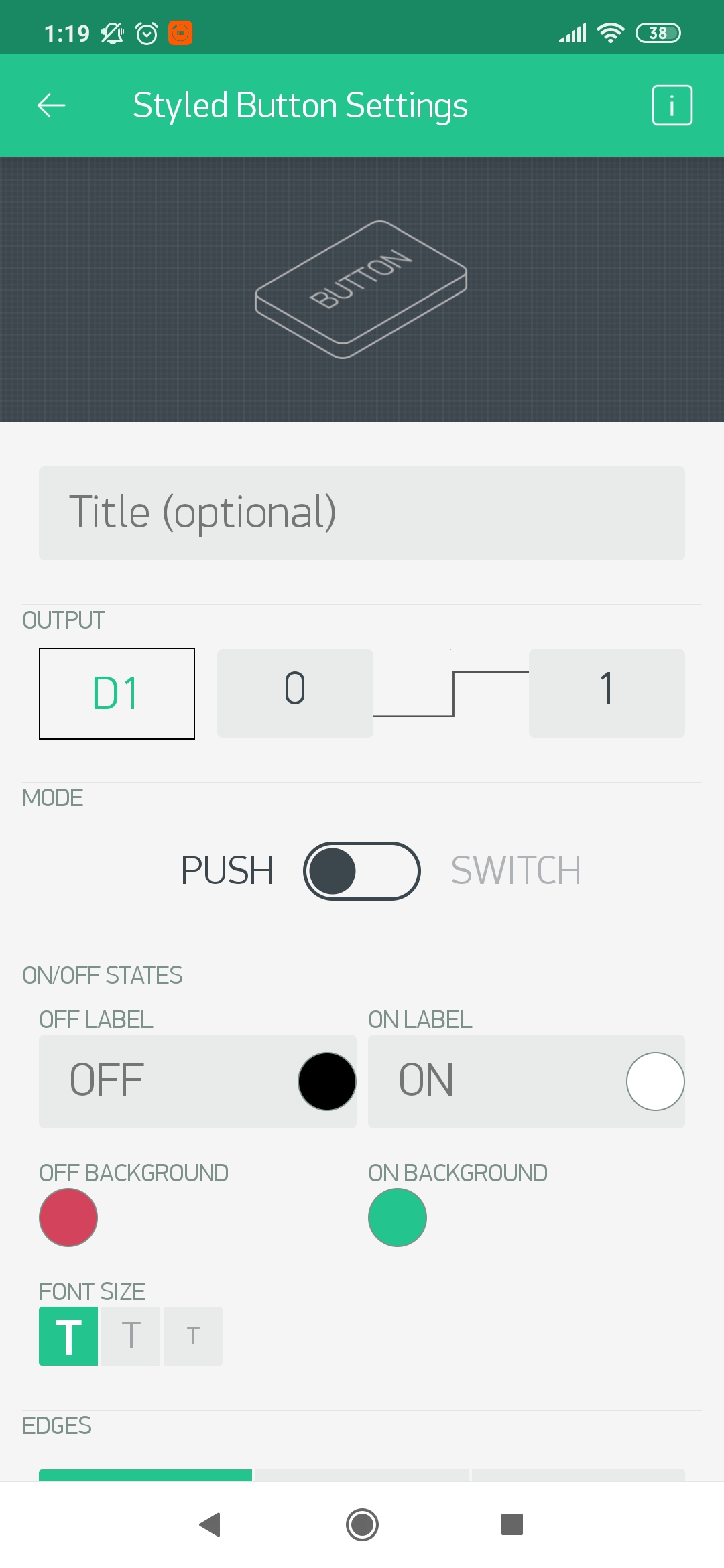

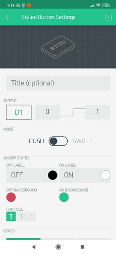

Button mode switch.
The button is in the off position.

it’s not working very well, it turns on and off on the app when I’m pressing on the app … I wanted to turn on the relay and it stay on for a few seconds and turn off by itself after that time
You should share your code (correctly formatted with triple backticks) along with details of how you’ve configured your app and how you have wired the physical LED.
