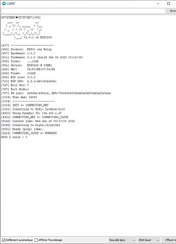

I try to reboot my device, but nothing happens.
Not working with ESP8266 or ESP32.
Any idea?

Thanks.
I have no file named ’ BlynkConsole.h’
I have
v1.0.1 on ESP8266
I think I have not done the correct update.
Download the files from here…
Thank you,
I updated all files and now it’s working.
My fault is from my last Blynk update.
