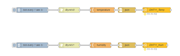

Thanks @scropion86. This worked perfectly. My final flow for humidity and temperature looks like this:
I’m running a local server so the URL string for reading V0 is: http://SERVER_IP:8082/TOKEN/pin/V0
