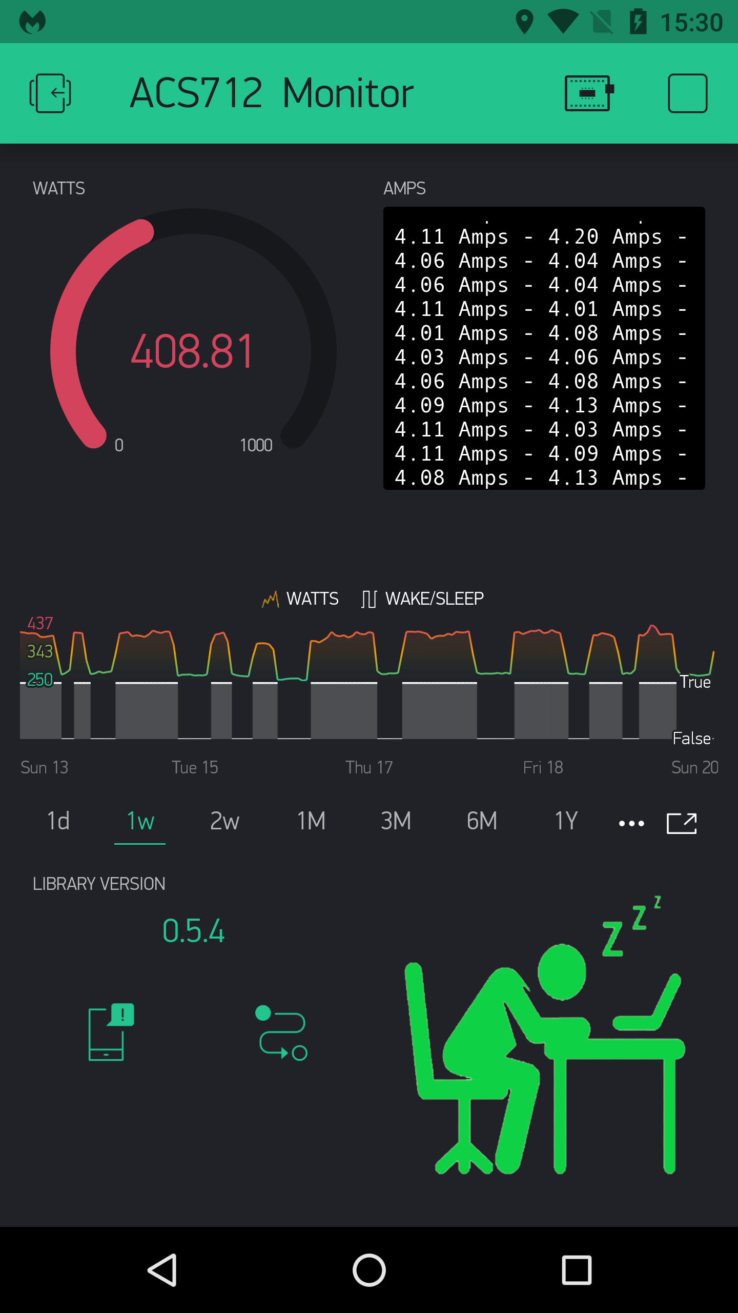

I use both for simple storage.monitoring of such data as power levels of my workbench… which doubles as my Sleep Cycle counter since I turn off the monitors when sleeping and thus lowers the current consumption enough to track.
