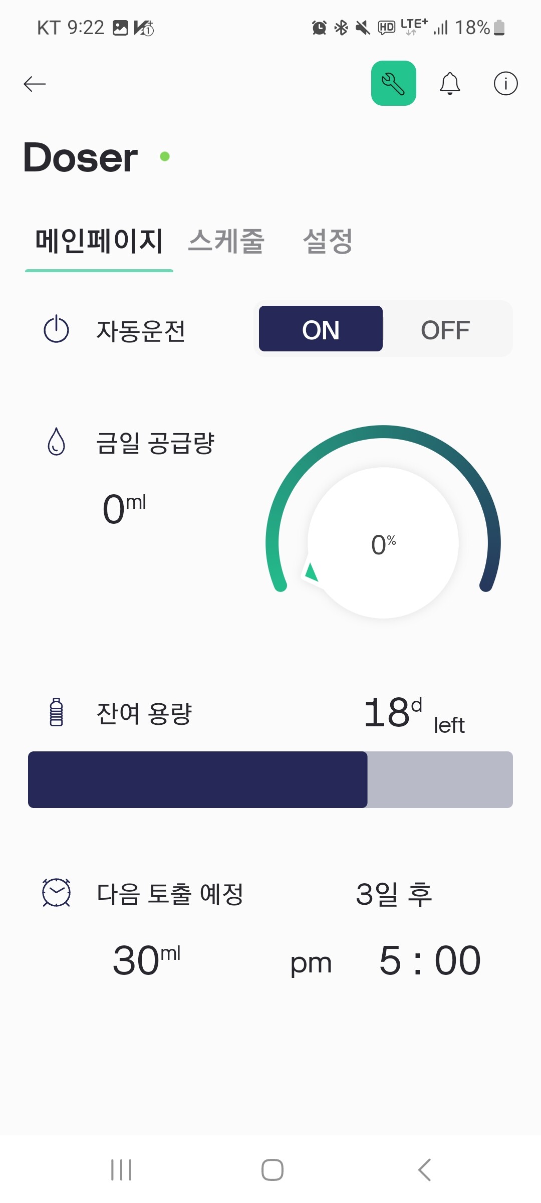

I am developing a product using Blink to control a motor at scheduled times.
As shown in the screenshot, when a schedule for motor operation is entered, the motor operates for approximately 5 seconds at the set time.
This product also includes a feature that displays the next motor operation time through the app.
However, there is an issue. The task of calculating the next motor operation time based on the entered schedule is handled by the firmware.
As a result, there is a delay in updating the next motor operation time after modifying the schedule, and if the device is disconnected, the next motor operation time isn’t updated at all.
I hope to modify this so that the app calculates the next motor operation time. If this is not feasible, I would at least like the server to handle this calculation.

I think I may have caused some confusion by not fully explaining the situation in detail.
The delay I was referring to isn’t about how long it takes to calculate the next motor operation time (which, as mentioned, only takes around 10μs), but rather the delay in data transmission.
When a user updates the schedule in the app, the data is sent through the app → cloud server → device firmware. The firmware receives the schedule, calculates the next motor operation time, then sends it back to the cloud server, which the app then reads and displays. This whole round trip takes about 1 second.
If the app were to calculate the next motor operation time itself, this delay wouldn’t exist, and the new time could be reflected immediately after the schedule is changed.
To clarify, the value I want to display in the app is not the remaining time until the next motor operation, but the exact time at which the next operation is scheduled.
Do you still think this would be confusing to users, even if the value shown is the scheduled time of the next operation rather than a countdown? I’d really appreciate your thoughts if you think that’s still a UX concern.
