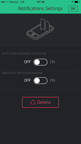

Here is a screen shot of the widget settings in my iPhone

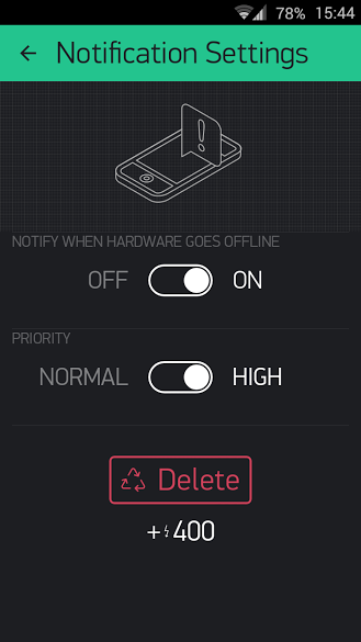

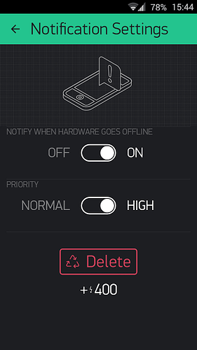

Our Android screenshot looks like the doc pages (no send even if app is in backgound). I guess they are the same thing (high priority on Android and send when app is in background on iPhone).
I am not sure about that? It almost seems they are different. When I read the docs info-
âPriorityâ - high priority gives more chances that your message will be delivered without any delays. See detailed explanation here.
But yet the way I understand the widget settings on the iPhone, SEND EVEN IF APP IS IN BACKGROUND would seem to be a different scenario.

Yes. HIGH priority means send even app in background.
Ok, thanks Dmitriy. The wording in the docs had me confused.
