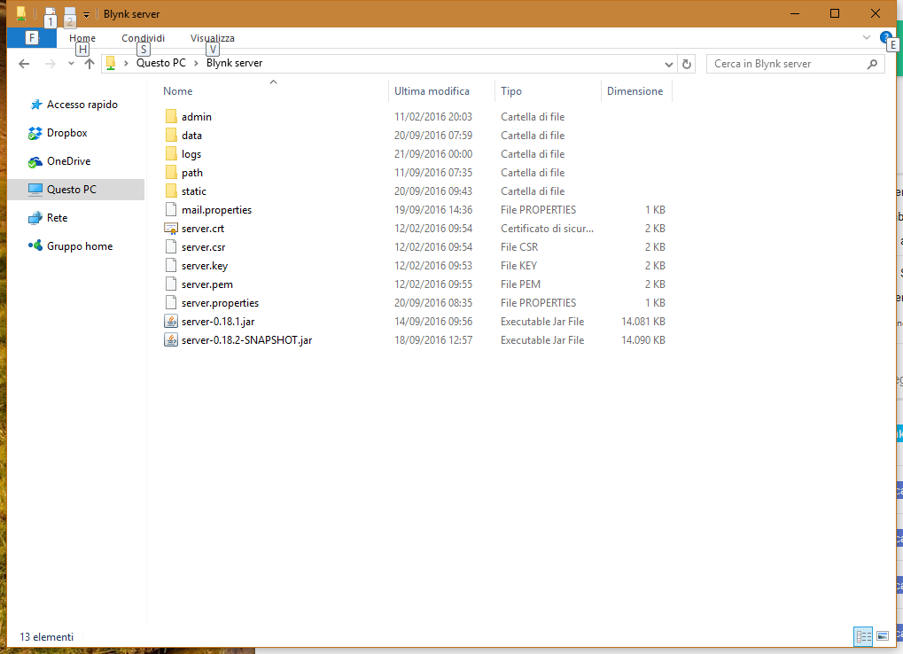

This is my blynk folder structure:
… and this is my mail.properties file:
mail.smtp.auth=true mail.smtp.starttls.enable=true mail.smtp.host=smtp.gmail.com mail.smtp.port=587 mail.smtp.username=naamah75@gmail.com mail.smtp.password=********
… but from the log file it seems that server ignore my properties files and pick confi from other folder (wich I ignore); serve try send by smtps.aruba.it instead smtp.gmail.com that I’ve writed down on the mail.properties file.
