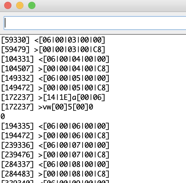

Ok, so I will need to connect the photon particle with a cable in my computer and read the serial port during the commands. Is this?
I guess so, I’m not familiar with the hardware.

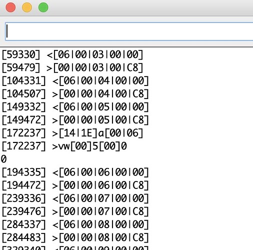

Ok, Here is the result. This is the same result from lamp and from LED.
Explaining: System was started to turn off the rele 3 and turn on after 2 minutes. But the system only turn off.
I another words, the automation work only one time.
If I repeat again, changing the switch to turn on when start will turn on, but will not turn off.
When you post serial monitor data you should copy the text from your serial monitor and paste it between triple backticks, in the same way as you do when you post code.
I assume that the serial output means Bert little to you? That’s because you have this line in your sketch…
