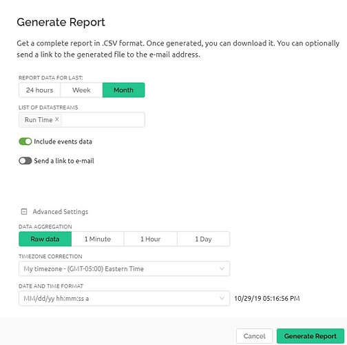

Please check if the “Raw Data” feature is enabled in the datastream settings on which you want to receive a report.
If the function is not enabled, you need to select in the “Advanced Settings”
any data aggregation type except “Raw Data”.

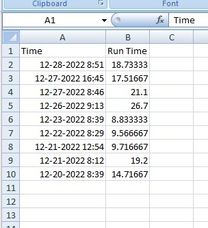

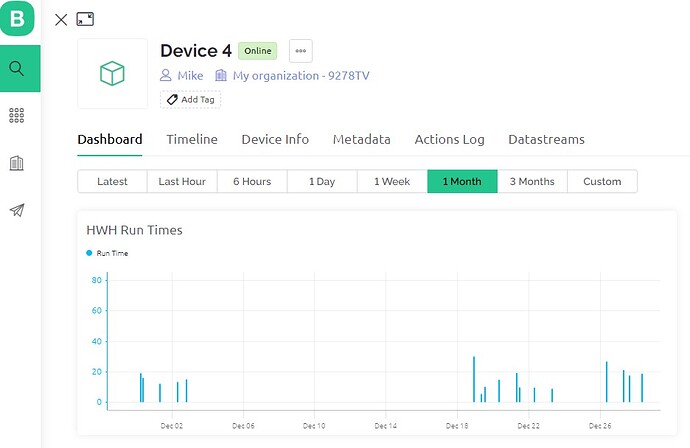

My graph shows data going back to 26 November 2022. But the downloaded data (1 month) goes only to 20 December (about 8 days).
See attached screenshots (graph and screen where I request the report). Also attached is am screenshot of the .CSV data file loaded into Excel.
Why can’t I download the same range the graph shows?

@Mike3 hello. did you switch “raw data” switch recently in the datastream settings? I mean, from what I see it looks like you didn’t have “raw data” enabled for that particaler DS and later it was turned on. Is that the case?
I was told to enable raw data a week or more ago and I did so. I turned on all the raw data settings for data streams used for graphs. But when I went back and looked yesterday it was disabled again. It seems like the raw data setting is disabling by itself. I’m sure I had it turned on.
It seems like every time I edit the data streams I see the raw data settings set to false. Could there be a bug with this?
There is always a possibility for a bug :slight_smile: . However, this settings if used very often so unlikely that’s the case.
What plan do you have? Did you try to select “1 minute” aggregation. Do you see the data 1 month back for it/
I have the Plus plan.
I believe I selected ‘Raw’ I will try 1 minute aggregation.
