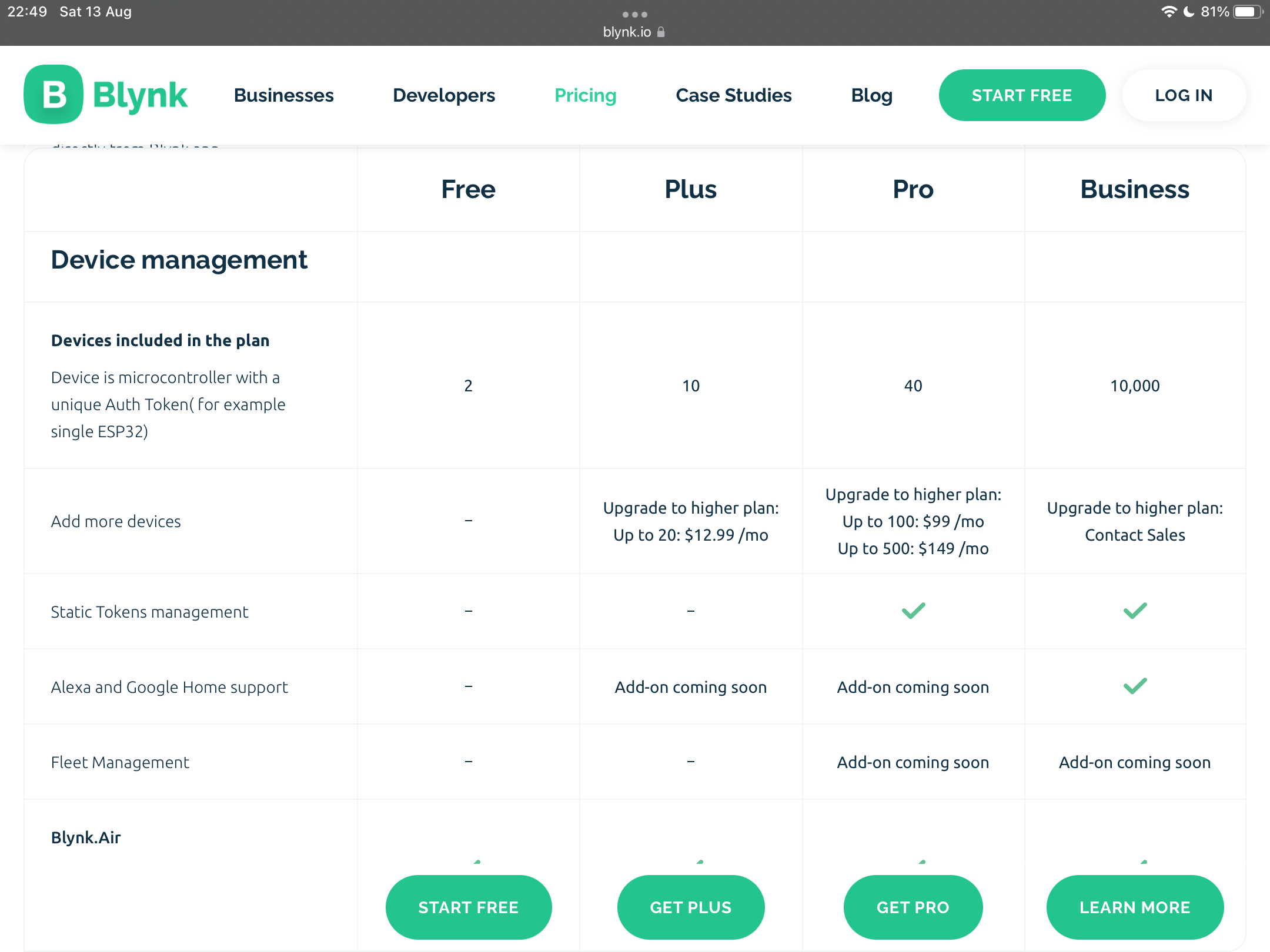

I am currently checking for princing, because I am still not sure if I stick with blynk legacy on local server or if I go to blynk2.0.
I’ve just saw that on the website :
20 pages, 7 device Info tabs, 1 welcome page
Does that mean that a “project” (like called in legacy) cannot have more than 7 ESP8266 for example on it ? Cause I actually use like 20 of them right now Oo
So in a single project, we could pick differents pin of so many devices.
Cant find anywhere the same kind of possibilty in blynk2.0, am I wrong ?
Please tell me I am wrong =p
In Blynk IoT each device is represented by a separate tile on the front screen.
There isn’t (currently) a way to display data from one device on another device dashboard, or transfer data between devices.
There are some workarounds to this, such as sending data from one or more ‘slave’ devices to a single ‘master’ device using the HTTP(S) API.
The solution I use is to use Node-Red and MQTT. This way, Blynk only sees one device and Node-Red is used to aggregate and assemble data from multiple devices and this is sent to a single Blynk dashboard.
More info on this approach here:
