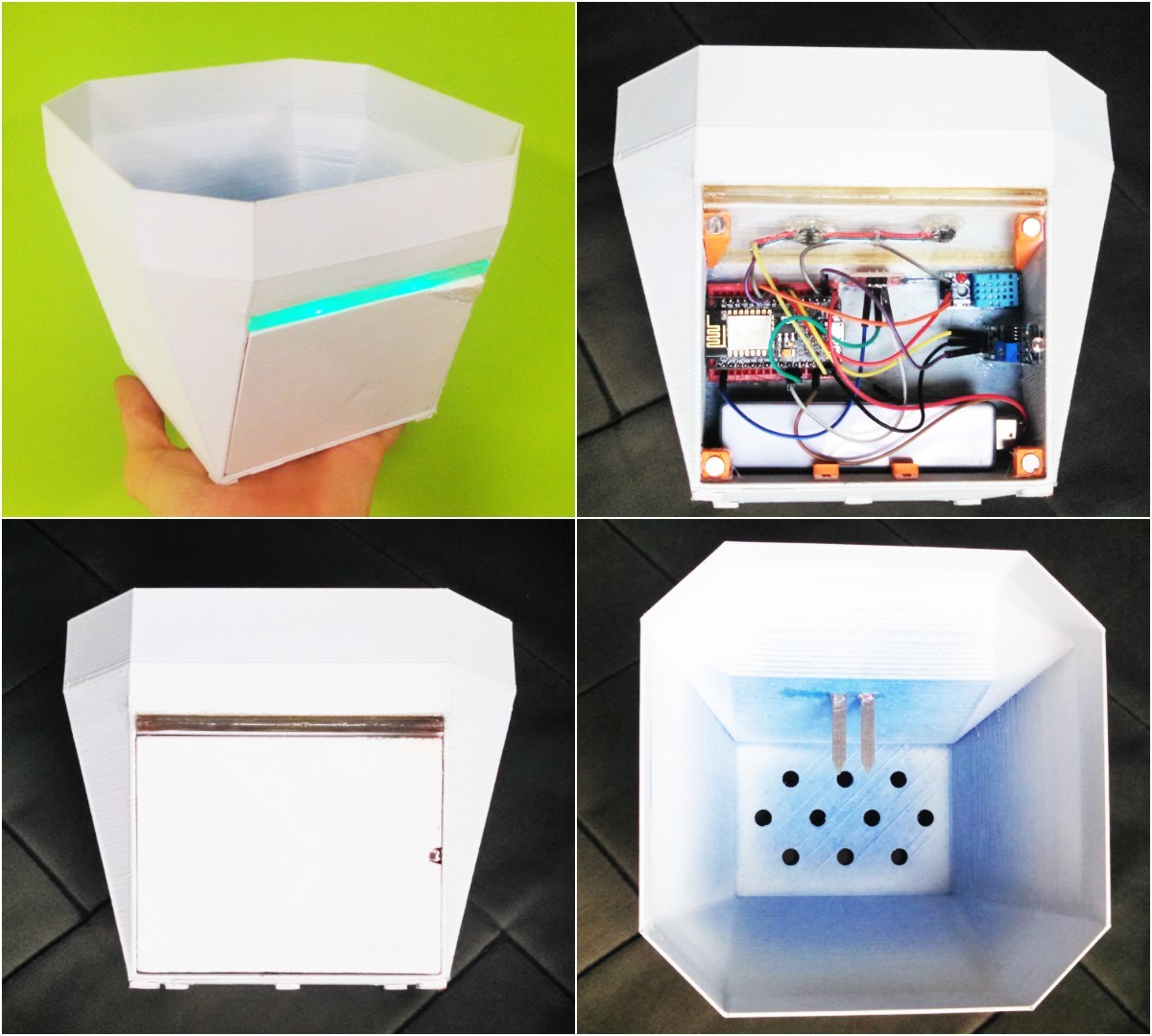

Pot2 smart plant pot / garden with nodemcu
hello everyone, just wanted to share a completed project… check it out.!!
