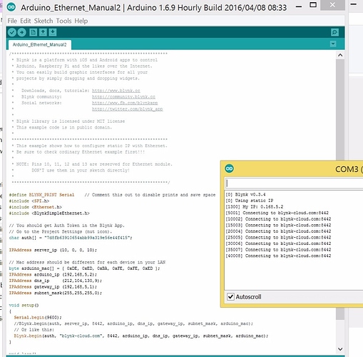

Attached is screen print of a blynk example sketch with network parameters completed. In this case the IP address of the arduino uno is 192.168.5.2 . During testing I see on my firewall a repeated 124 byte packet (tcp 8442) being sent with this correct address and a 84 byte packet returns every other send.
The blynk app reports that there is no arduino connected.
The serial monitor shows this connection request but doesn’t give any clues as to the reason for the failure to connect.
Its not clear to me if the ip address error show in the serial monitor (0.168.5.2) is anything to do with this problem.
I guess I’ll have to look at the returning packet with wireshark to see if that gives any clues unless anyone else has any ideas.

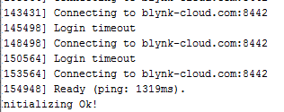

I have no clue what your issue is. However, you can see by the screen capture that I have included, I have had some very long connection times.At other times I connect right away using the exact same hardware on the same network running the exact same sketch. I just let it go and at some point it connects.
Good Luck
Thanks for that response. (It seems other users are also getting delays.)

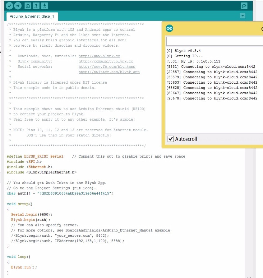

Have now changed from manually setting IP addresses to DHCP and just putting the auth key in the sketch.
The latter also results in the serial monitor suggesting the address is 0.168.5.111 (pool starts at 111).
A screen print is attached below for completeness.-
