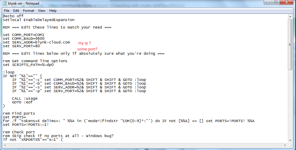

I still dont have any idea, but I think I can just keep trying. But off topic, I got facinated that Blynk team has solved, something very intresting, infact sending Arduino data over USB without Internet shield to app. So I thought if there is anyway to do it, to send that data to your local server or even over Internet. I even googled it how to do it without blynk and some said, its impossible Blynk gave some another server file with that sending data over USB and if I make some slight changes in code, can I use that same way as blynk-cloud? I mean, does it work?
Now this, unlike Port forwarding, IS Blynk related
Yes, that USB-Link simply turns your PC into an oversized Serial to Ethernet adapter and will work with Local Server as well.
I use these settings on one of my UNO’s The IP is for my Local Server inside my network… I can use port forwarding to connect to that Server from away from home.
NOTE the correct port to use is 8080

Thanks! I will try this in the morning :D. So you opened port 8080 and public ip is 10.10.3.13. My router wants public and private ports seperately and is not satisfied with only one port, but wants range of ports. Also off topic question. I read that I have two ip-s one is local like 192.168.0.30 and public is 90.191.160.181 So I must use public IP as remote ip? Stupid questions anyway. But teachers used to say that there is no stupid questions, but answers
NO. Port 8080 is for the devices (the script) only to connect to the Local Server… of which it’s IP is on the Private side.
For port forwarding (which is not required with the USB link) you would redirect the App’s port (9443) from your router’s public IP (whatever your router gets from your IT service) to your Local Servers Private IP.

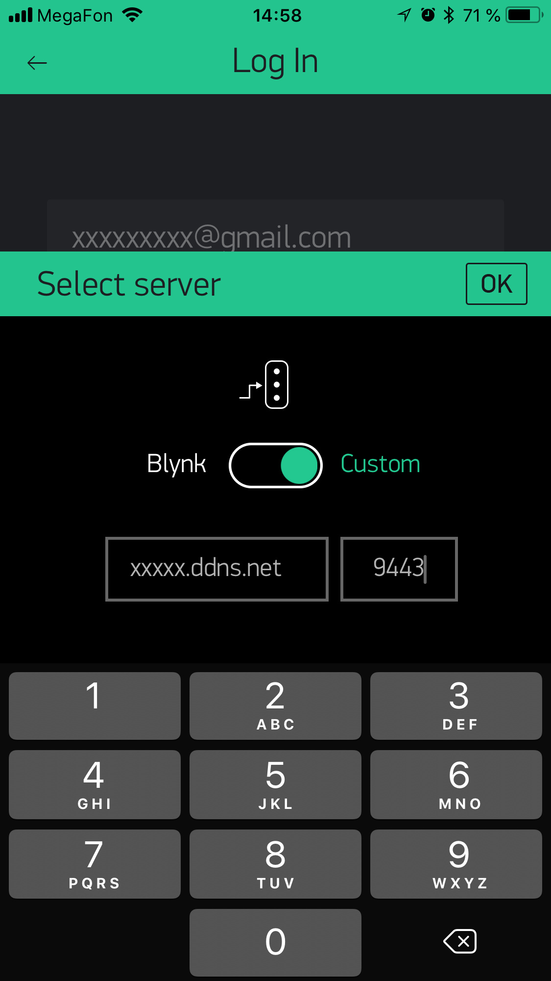

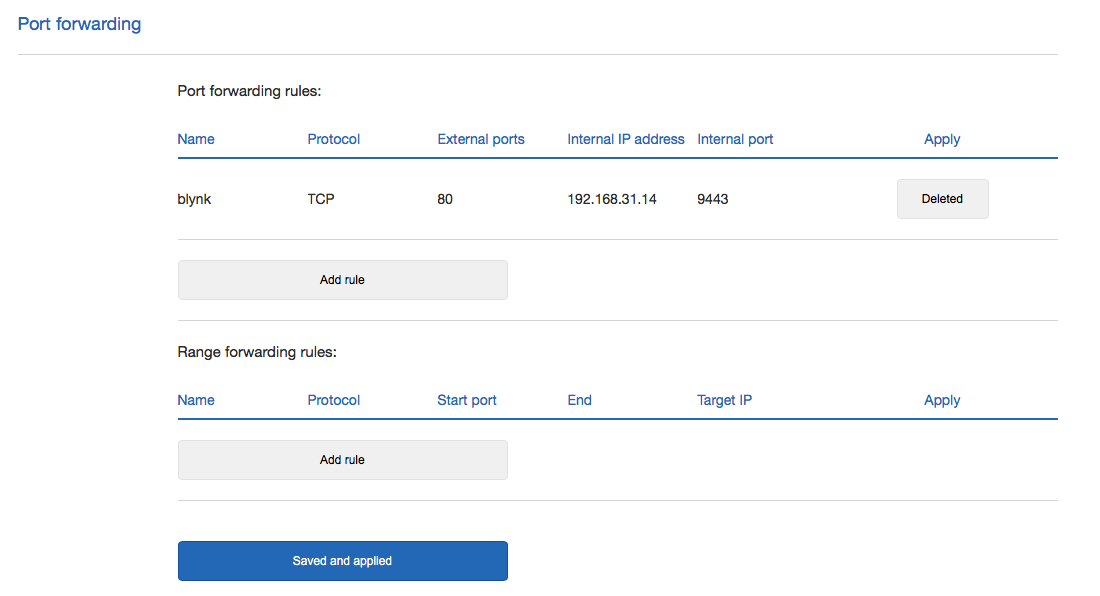

I’m also trying to connect to my local server.
My external IP is dynamic, and I have done the following:
created an account on www.noip.com , and used it in Blynk app
Not sure if i need to specify port range. If yes, then what is this range for non-ssl connection?
The app keeps on telling me that ‘You don’t have internet connection’…

I might be wrong, but I think, that your ISP use double NAT or something similar. The public/private and dynamic/static IP adress are not the same thing. You said, that you have dynamic IP, so you used no-ip, that is fine. But if you have private IP address, you will not be able to connect to your PI on LAN from outside. Also, i do not recomend you to use ports like 20, 21, 25, 80, 81, etc… Because these ports are more likely to be blocked by ISP because botnets attacks to everything with opened common ports. At least by my own experiences. So, find out, wich type of IP you have. Then, try port froward to eg. not 80 but 5123, or something simillar random 4 number
