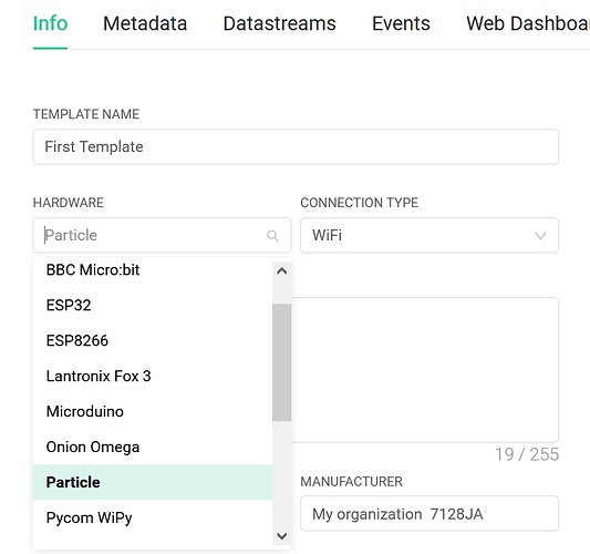

In the web console, I added “Particle” as the device.
I then had to set up manual datastreams for the relevant pins.
I’m using the blynk library that can be installed via Particle Workbench, and I’m using Particle Workbench.
